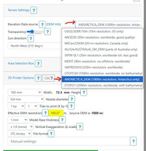

Go to https://touchterrain.geol.iastate.edu/main (TouchTerrain), which allows terrain to be converted into 3d printable STL files. Then, select an elevation data source that doesn't contain your mountain, as this will make it easier to find it (I chose ANTARCTICA_DEM), as my mountain is in Nepal (Image 1). This is optional, but it makes it easier to find your mountain on the map. Now, search for your mountain in the search bar and zoom in/out to get your mountain into the view that you want (Image 2).
Secondly, switch your elevation data source to the one that you want. I would recommend USGS for mountains in the US, but AW3D30 for the rest of the world. I selected AW3D30 since Mt. Everest is in Nepal (Image 3).

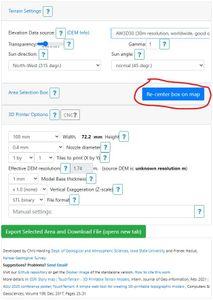

Click the blue "Re-center box on map" button to place the red square over your mountain (Image 4). The red square is the area where an STL would be exported. Take the corners or edges of the red box to adjust it until it includes the part(s) of the mountain/terrain that you want to 3d print. I included most of Mt. Everest without including the other mountains in the Himalayas (Image 5).

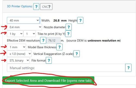

To create the STL, set the width of the 3D model (the height is automatically calculated). If you want a small keychain, choose 40-50 mm, but if you want a paperweight, choose 70-80 mm. I chose 40 mm for the keychain and 70 mm for the paperweight, since I am creating both (Image 1).
Select the nozzle size of your printer. Then, select the amount of tiles that you want (this can be used to create larger models with more pieces). Since I am making miniatures, I'm only using 1 tile. Then, choose the model base (this is how many mm of material are printed underneath the model. I chose 1 mm, the default.

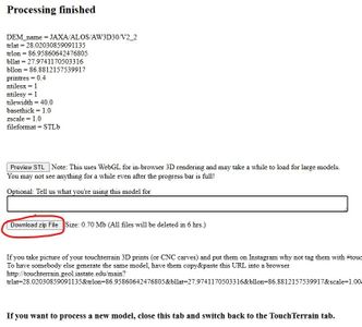

Choose the vertical exaggeration (x1.0 is recommended because mountains are being printed), the file format (STL to 3D print), and click the green Export button (Image 2). Once it redirects, click the gray "Download zip File" Button to download a Zip File with your STL model inside (Image 3).
