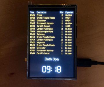

National Rail Departure Board showing real-time departure information from any rail station within Great Britain on a 3.5 inch 320 x 480 pixel TFT display. Uses Raspberry Pi PICO 2W microprocessor.
Overview
  1. Designed to emulate the look of a typical station departure board (Figure 1).
  2. Pulls data from National Rail's LDB Webservice data feed.
  3. Departures for up to 15 services can be displayed.
  4. The station can be selected from a user defined list of 24 stations (Figure 2).
  5. The display also shows the current time derived from NTP server.
  6. The user’s Wifi SSID and Password are held on the SD card in a text file “WiFi.txt”
  7. The user’s list of stations is held in on the SD card in a text file “myStations.txt”.
