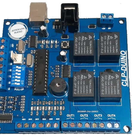

The Mini PLC card consists of a card developed by the Jefferson Bueno Channel on YouTube and allows you to use learning in low cost programming in relation to PLC commercials.
The aim is to create an open software and open hardware product with commercial components of easy access.
A very practical and didactic circuit that can be used for learning or even in a final project.

Step 1: Knowing the Basic Operation
The board has 06 (six) pre-selected 24Vdc digital inputs and 05 (five) is also allowed (four for output and one for bell), in addition to having 06 (six) 5Vdc digital ports where the user uses in its programming if the digital input or output, if using these digital ports, as input it will enable PULL-UP resistors by means of the DIP, leaving it ON and if it is going to be used as an output, leave the DIP for the port in OFF.
Step 2: Using the Arduino on the MINI PLC
The Mini PLC allows programming in Ladder and also in C Aduino Language. It has six inputs prescribed on pins 4/5/6/11/12/13 of the Atmega328P microcontroller and five outputs using pins 23/24/25/26/27 of the microcontroller the four first pins are dedicated for the relays and the last for the buzzer. Still, there are six digital ports (pins:14/15/16/17/18/19) that can be programmed as input or output, being 5VDC different from the prescribed 24VDC inputs. If you want to use these digital ports as inputs, you can use the pullup resistors that can be connected via the SWITCH DIP and use it as an output, just turn off the pullup DIP. To start using, you need an Arduino Uno R3 connected to MiniPLC and after finishing the software you can leave the Arduino connected or remove the Atmega328P from the Arduino and connect it to the 28-pin socket of the MiniPLC board.
Step 3: Software and Programming
As the circuit is based on the use of Arduino UNO, its programming can be done through the Arduino's own software as well as a LADDER software can be created by LDMICRO, which in case AVRDUDES is necessary to record the HEX file generated in LDMICRO.
Thus enabling the programming in C programming language and also in LADDER language.
