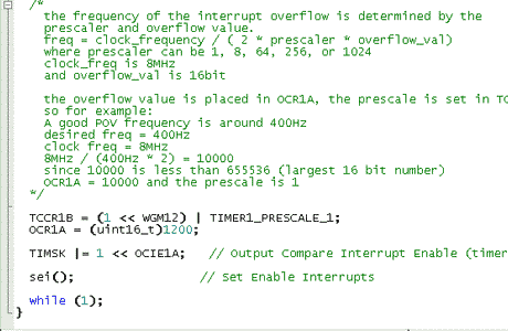

Step 6: Programming the Chip and Fixing the Timing
I wanted the letters to be nearly proportional, so I did the math, found the circumference that the LED's traveled, divided out the distance by the height of the LED's and found out I could have 133 columns of text.
I use this software to generate the code for the text.
Download and install WinAVR so that you can see the C source code of the MiniPOV2 and edit in your own sign.
When I first got the program downloaded into the ATtiny2313, and spun it up, it was so COOL. The only problem was that the motor was spinning to fast for the text. You'll have to go into the code and adjust the part that says "OCR1A = (uint16_t)1000;" and adjust the 1000 to what best suits your motor, and tastes. I had to adjust mine to 1200 to make it slowly spin.
