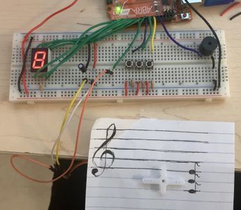

I made a mini piano on an Arduino uno using a buzzer to create sound, a 7-segment to display the note being played, and a servo motor to display the notes on the staff
Step 1: Power and Ground
Connect the power and ground accordingly as shown in the image above.
Black wire = GND
Red wire = Power
Step 2: Buzzer/Piezo
Connect the piezo to pin 13 and connect the piezo to the ground. As shown in the image above
The purpose of the piezo is to play the sound of the notes.
Step 3: Push Buttons
Connect the pushbuttons to pins 10-12. Connect the pushbuttons to power and ground using wires and resistors. As seen in the image above
The purpose of the pushbuttons is to play a note using the buzzer when pressed
Button1 = Pin 10
Button2 = Pin 11
Button3 = Pin 12
Step 4: 7 Segment
Connect the 7 segments accordingly. as seen in the image above
The purpose of the 7-segment is to display the note being played based on the push button pressed
a = Pin 7
b = Pin 8
c = PIn 4
d = Pin 3
e = Pin 2
f = Pin 6
g = Pin 5
Step 5: Servo Motor
Connect the servo motor to power and ground through a capacitor, as well as connect it to pin 9 as shown in the image above.
The purpose of the servo motor is to display the note on the staff according to the pushbutton being pressed

Step 8: Picture of the Finished Project
You have now completed your mini Piano!
Here is a video of how the toy should work: Video
