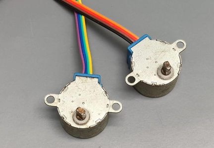

Step 1: Converting a 28BYJ-48 Stepper Motor From Unipolar to Bipolar
First, remove the blue plastic cover of the motor with a sharp flat screwdriver. After removing the blue plastic you will have access to the path we need to remove. Can you see the cut in the picture above? That is best cut with the tip of a sharp knife. We only need to cut the path in the middle just like shown in the picture. Make sure that the cut is deep enough and there is no contact between its two sides – otherwise the motor will not work as a bipolar one. We just need to put back the blue plastic cap to its place and we are done. The thing you might want to do is to cut the red wire before closing the cap since we will no longer need it.

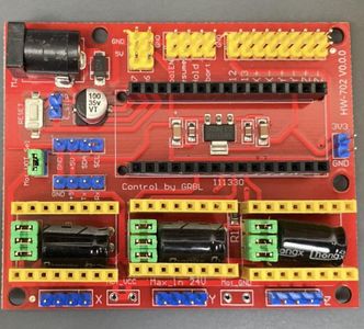

Step 2: CNC Shield V4 Clone Fix
On online platforms there are various cloned CNC Shields for the Arduino NANO.
They are cheap and of good value but if you want to set Micro Stepping as they are, you can't.
Whoever made this shield made a mistake and put the pins that should go to Vcc to GND.
As the pins that set the Micro Step Mode are already pulled down to GND internally as default, and to change their state, they need pulling up to Vcc.
Watch this video tutorial to fix this error.

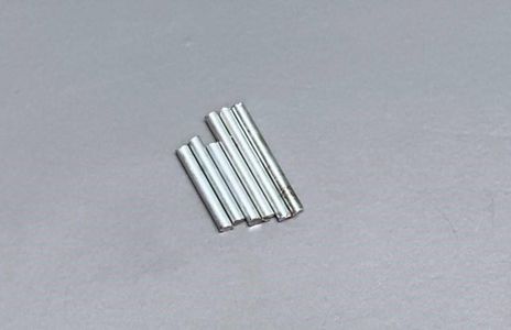

Remove the broken lcd screen from the tab. A 3d printed part drill guide is used to locate the points where to drill holes. Two 3D printed pulley is attached to the shaft of each stepper motor. At each corner of LCD writing tab in pair of two idler pulley is mounted on the small rods. Linear X-axis and Y-axis consists of bicycle’s spokes which moves linearly perpendicular to each other. A 3D printed slider moves Forward/Backward and Up/Down which carries Servo motor whose arm attached with a pen.
Rod Diameter = 2mm
X-axis rod length = 23.5 cm
Y-axis rod length = 17.0 cm
For Pulley Rods:
3 Rods length = 10 mm and other 3 rods length = 15 mm
The thread is bounded over the pulley. This Thread carries X and Y axis rods. Left Stepper motor controls the X-axis rod and right Stepper motor controls the Y-axis rod. You can download STL files of 3D printed parts provided at the end of this tutorial. Both stepper are attached at the back of the LCD pad with the help of super glue.
