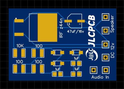

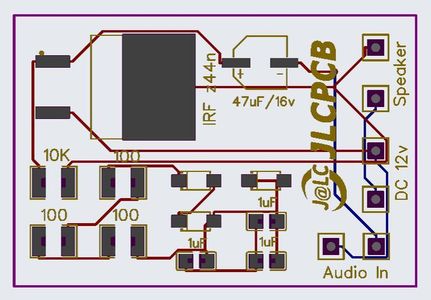

Step 5: Schematics and PCB Design
The schematics of PCBs can be seen above.

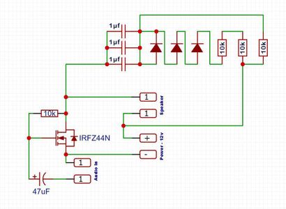

Step 6: Circuit Connection – Step 1
To make this Mini Power Amplifier Circuit, 1st we connect 10 KΩ resistor with “Drain” and “Gate” leg of Mosfet. Then we connect 47µf/16v capacitor with the circuit. We connect this capacitor positive leg with “Source” leg of Mosfet. Now we connect this capacitor negative leg with audio input ground cable.
We utilize JLCPCB https://jlcpcb.com/RTA to printout our PCB.
Step 7: Circuit Connection – Step 2
Now we make a parallel connection with this 1µf ceramic capacitor. Then we make a series connection with 3 pieces rectifier diode. Then connect ceramic capacitor with diode negative and positive leg.
We also make a series connection with this 3 pieces resistor. Then connect resistor 1 terminal with diode positive leg and connect it’s other terminal with positive leg of DC 12v.
Step 8: Circuit Connection – Step 3
For input power, we are using DC 12v. We connect DC 12v positive leg with 1 terminal of sound speaker and connect DC 12v negative cable with source leg of Mosfet.
To get output , we need to connect a sound speaker. Sound speaker 1 terminal is connected with power source and we connect it’s other terminal with “Drain” leg of mosfet.
Finally connect audio input L/R cable with “Drain” leg of mosfet and our amplifier circuit is now ready for use.
