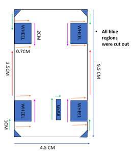

Step 1: Design a Chassis and Measure Your Parts
I designed a basic chassis with the measurements I wanted for the length of the car. Ensure it is large enough to allow your larger spur gear; 's diameter and a 2cm (approximately) steering system to fit. Along with this, account for your motors, one will be vertically placed towards the front wheel on the plane of your chassis.
Here are my measurements, although depending on the availability of material and microelectronics, you can make yours smaller and cram a few parts.
Here I used an extra PVC sheet to cut out the chassis. I used an iron set to its maximum temperature and parchment paper to flatten a PVC pipe into a sheet. The pipe will warp as it heats up, use a heavy block/book to keep it flat as it cools. Cut according to the template above or your own.

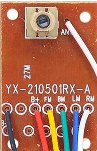

Step 4: Reciever and Transmitter
Let’s start by understanding the ports. B+ and B- are the positive and negative inputs for the receiver. FM stands for front, BM for back, and LM and RM for left and right, respectively. The ANT wire connects to an antenna, but it’s unused in this tutorial.
The transmitter, the longer horizontal board, is easier to understand. Each button corresponds to FM, BM, LM, or RM. On my board, these weren’t labelled, so I tested the buttons with 2 motors and the receiver before soldering it to the mini model. The white wells with the screw control the range—unscrewing increases the range and vice-versa.
Note: Do not unscrew too much. These wells can crumble with even slight resistance.
(Let's just say, I learnt from experience ._.)
Creating the Circuit:
Connect BM and FM to either end of your gearbox motor. The motor pin connection doesn’t matter as the module reverses the current direction. Connect LM and RM to your steering motor. Then, connect the +ve and -ve wires to the corresponding terminals on a 3.7V 500mAh battery. A higher mAh will overheat and damage the module.
