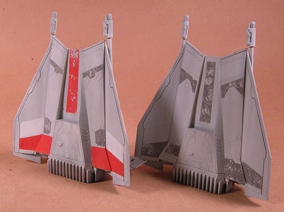

Bottom view photographs:
http://fichtenfoo.net/blog/wp-content/uploads/2010/01/snowspeeder-04.jpg
http://fichtenfoo.net/blog/wp-content/uploads/2010/01/snowspeeder-07.jpg
http://www.thesabervault.com/files/MasterReplicas/Items/Snowspeeder.jpg
