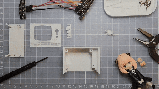

Step 3: Print 3D Model
Please download and 3D print the model at thingiverse:
https://www.thingiverse.com/thing:5759790
Note:
The antenna model have few versions, it depends on what type of antenna you want to build.
The legs model also have 2 versions. If you found the leg of normal version break easily, try the long version that have thicker legs.

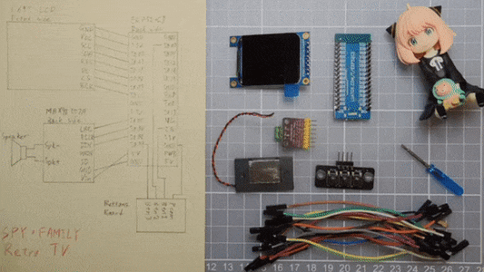

Step 8: Connections
Here are the connection summary:
ESP32-C3 LCD MAX98357A Buttons
GND -> GND GND PCOM
3.3V -> VCC
5V -> Vin
GPIO 02 -> SCL
GPIO 03 -> SDA
GPIO 10 -> RES
GPIO 06 -> DC
GPIO 07 -> CS
GPIO 11 -> BLK
GPIO 05 -> LRC
GPIO 04 -> BCLK
GPIO 08 -> DIN
GPIO 09 -> 3rd button
GPIO 00 -> 2nd button
EN -> 1st button
Please follow the video for the connection and testing steps:
Step 9: Case Assembly
Please follow the video for the case assembly steps:
