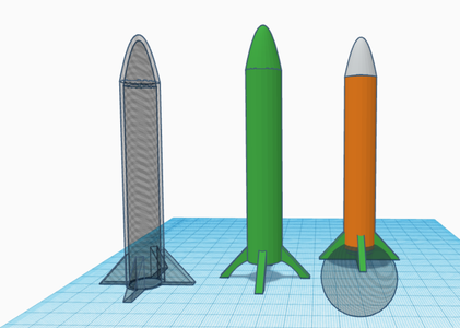

In the picture, you see two of the many possibilities with only basic shapes. They will need to use the align tool (to center the smaller inner tube to subtract from the bigger one to make everything hollow), pay careful attention to the measurements (since it needs to fit the rocket fuel and the cork), think about how it will be printed (preferably without support structures)... I prefer not to give them an example, so they will start from their own imagination.
(The green one in the picture leaves some room for the cork to fit while the rocket is standing upright, but needs support structures to print).
