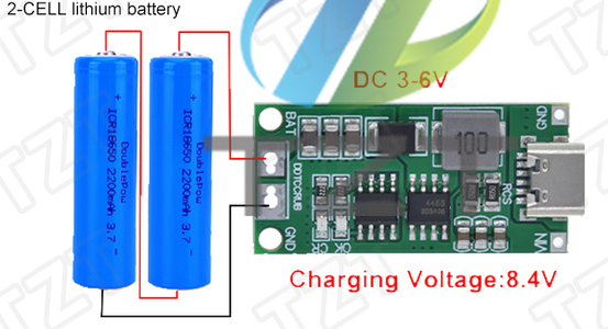

5. Multi-Cell 2S Type-C LiPo Polymer Li-Ion Charger - $1.67
https://www.aliexpress.com/item/1005004284040944.html?spm=a2g0o.order_list.order_list_main.117.7f491802fJ0KOJ

Step 1: Connecting
Connecting the switches so that the motor rotates in both directions.
