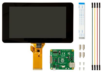

- 7” Raspberry Pi Touch Screen (optional)

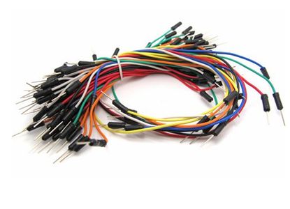

- Jumper Wires: Male to male for arduino to sensor. Male to female for raspberry pi to arduino.

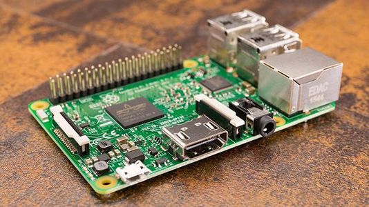

- Raspberry Pi 3 Model B (optional)

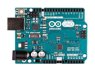

- Arduino Uno

The raspberry pi and touchscreen is only used to display our app using Universal Windows Platform in Visual Studio. The app as I have said earlier consist of 2 radial gauge. 1st radial gauge is to display the distance and 2nd radial gauge is to display the ADC value.

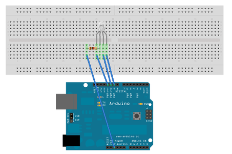

Step 6: RBG LED Light
Connecting this is pretty easy too. The only tricky part again is to get around making good use of the breadboard.

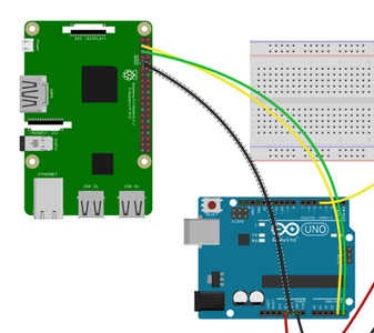

Step 8: Connecting Arduino to Raspberry Pi
Connecting Arduino to Raspberry Pi. I have attached everything you need to know in the image above. No worries
Step 9: Connect Raspberry Pi to Touchscreen
Above is a demo on how to attach your raspberry to led touchscreen if you have not done so
