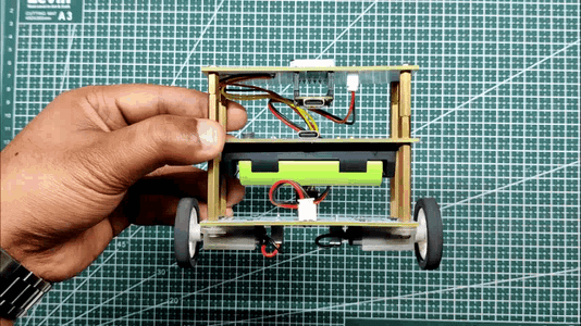

Step 1: Design
This design did not necessitate any major 3D Printed components, so no 3D Model was required; however, we reused 3D Printed Micro Gear Motor Holders from a previous project, which was this-
https://www.instructables.com/Dual-Motor-Driver-As-Robot-Base/
The idea was simple: we have three boards with the same dimensions (95mm x 35mm) and mounting holes (four 2.8mm diameter holes at each vertex), so they can be easily connected using PCB standoffs.
We used a 3D-printed motor mount with two holes on each side to mount the motor on the base PCB.
The middle layer will house the battery, while the top layer will house the gyro sensor and microcontroller.

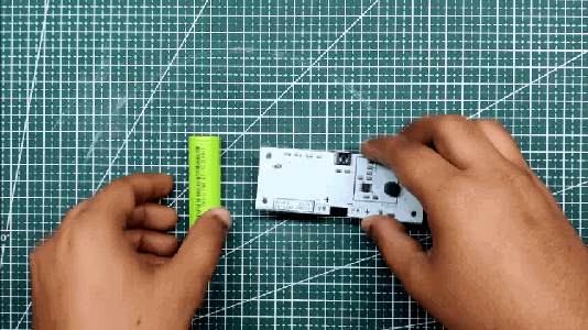

The Battery Board is a simple IP5306 IC-based setup that is a power management setup for Lithium Ion cells; it boosts the lithium cell's 3.7V into constant 5V and has a battery indication feature, LED indication for battery charge level, and low and high voltage cuts, making this setup perfect for a small robot project that requires 5V input with a single lithium cell.
you can read more about IP5306 from its datasheet -
http://www.injoinic.com/wwwroot/uploads/files/20200221/0405f23c247a34d3990ae100c8b20a27.pdf

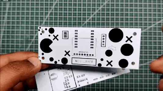

Finally, we use a microcontroller and the GRYO board, which is a simple breakout board for the XIAO ESP32 Board, which is connected to the MPU6050 sensor module and has a CON2 port for power input and a CON4 port for Motor Driver control pin output.
All three boards were modeled using same board outline, only the component placement was changed.

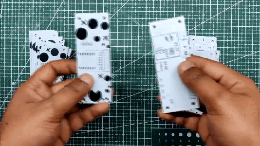

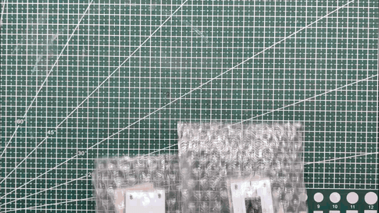

Step 3: Seeed Studio Fusion Service
As for the PCBs in this project, they were sent to SEEED Studio for samples.
An order was placed for a white solder mask with black silkscreen for all boards.
PCBs arrived in less than a week, which was super fast.
The quality was very good considering the price, which was also pretty low.
The PCB quality of both PCBs was just awesome!
Seeed Fusion PCB Service offers one-stop prototyping for PCB manufacture and PCB assembly, and as a result, they produce superior quality PCBs and Fast Turnkey PCBA within 7 working days.
Seeed Studio Fusion PCB Assembly Service takes care of the entire fabrication process, from PCB manufacturing and parts sourcing to assembly and testing services, so you can be sure they are getting a quality product.
After gauging market interest and verifying a working prototype, Seeed Propagate Service can help you bring the product to market with professional guidance and a strong network of connections.

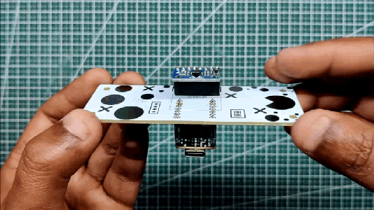

Step 4: XIAO MCU Board Assembly
  • The TOP Layer is the microcontroller and gyro board, which consists of an XIAO Board with MPU6050.
  • We solder two CON7 header pins on XIAO pads and one CON8 in place of MPU6050, and that's pretty much the end of the assembly process for this board.
  • Then, on one side, we insert XIAO, and on the other, we insert MPU.

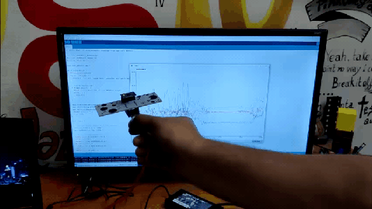

Step 5: Test Sketch for MPU6050
The MPU6050 is a well-known sensor module that integrates a three-axis gyroscope and a three-axis accelerometer into a single package. It also has an on-board Digital Motion Processor (DMP) that allows complex calculations to be offloaded from the main microcontroller, greatly simplifying the implementation of motion tracking in embedded systems.
Here are some key features of the MPU6050:
  • Six degrees of freedom (6DoF) sensing: The MPU6050 can detect motion along the X, Y, and Z axes using both the accelerometer and the gyroscope.
  • Digital Motion Processor: The on-board DMP can perform complex calculations such as motion fusion and sensor calibration, offloading this processing from the main microcontroller.
  • Wide operating voltage range: The MPU6050 can operate on a voltage range of 2.3V to 3.4V.
  • Communication interface: The module can communicate with a microcontroller using either I2C or SPI.
  • Low power consumption: The MPU6050 consumes only 3.9mA in full operating mode, making it suitable for use in low-power applications.
The MPU6050 is commonly used in applications such as quadcopters, robotics, gaming, and wearable devices.
We need to install the MPU6050 library before uploading the below test sketch.
https://github.com/adafruit/Adafruit_MPU6050
  • We open example sketches> Adafruit MPU6050> plotter and upload it into the XIAO Board.
  • Next, we go to Tool Menu>Serial Plotter which will open the graphs which will be plotted by using readings taken by MPU6050.
Readings will change if we move the microcontroller board up, down, left, or right.
This sketch will show that the MPU is working with the XIAO setup.

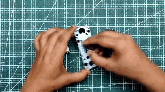

Step 6: Battery Board Assembly
  • We begin with the solder paste dispensing process, applying solder paste to each component pad individually.
  • We then used an ESD tweezer to carefully pick and place all the SM components in their assigned places one by one.
  • After the "pick and place process, " we carefully lifted the whole circuit board and placed it on the Reflow hotplate.
  • We then put the Lithium cell holder on bottom side of the board using soldering iron.
  • Board assemby is now completed.
Step 7: Battery Board Test
  • Before we use this Bboardoard in Robot, we need to make sure it works.
  • We place a lithium cell in its holder on the bottom and use a multimeter to measure its output voltage, which should be 5 volts.
  • Finally, we connect a smartphone charger's Type-C port to this board to see if it charges.
  • The indicator leds were blinking, indicating that the cell was charging; this concludes testing, and we can now proceed to the main assembly process.

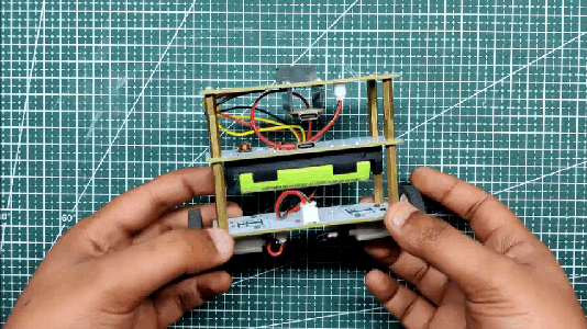

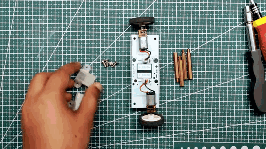

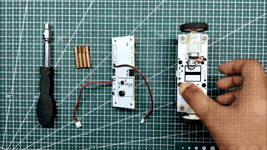

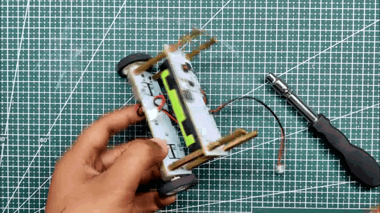

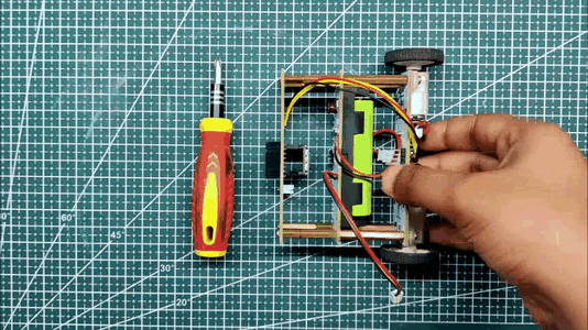

Step 8: Robot Assembly
  • We begin the main assembly by connecting all three boards together, with the battery board's 5V and GND connected to the microcontroller board and motor driver board. The XiAO CON4 Port is linked to the motor driver input to control the gate of fets.
  • We temporarily remove the wiring from the motor driver board in order to add motor mounts and PCB standoffs to the board.
  • Next, we use PCB standoffs to connect the battery board to the motor driver board, and we add four more standoffs to the battery layer to connect the top layer.
  • After connecting all of the wires that were previously added, the assembly is complete.

We began by installing the MPU6050 library and uploading one of its example sketches, a plotter sketch.
The graph changes as the robot moves up and down, indicating that the MPU6050 is functioning properly.

Step 10: Error in Board
Because XIAO had some issues with the main code, I had to remove it from the board and replace it with the Arduino Nano. As a result of this change, I had to rewire everything, which meant that the pinout had to be reduced and manually soldered to the Arduino Nano's pins.
The main code worked with nano, but there was a problem with the motor driver, which caused mosfets to fail frequently.
Step 11: Conclusion
The gyro part worked, but it had sensitivity issues, so a support was added to keep the robot from falling over. The motor driver had noise issues, and the motor randomly turned on and off without providing its gate signal.
Overall, this project was a shambles, but here's what needed to be changed in Version 2: the motor driver board requires diodes and two additional fets to enable each section's power flow, and much more powerful fets should be installed instead of the AO3400 SOT23-3 package.
The microcontroller layer must then be modified in accordance with the Arduino nano setup.
We will be able to run this small bot by making these changes; it currently works but not perfectly.
