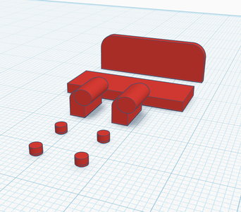

I designed the project to real-world scale using these dimensions using Autodesk's Tinkercad:
Sofa base: 25 cm long × 9 cm wide × 2 cm tall (9.84 in × 3.54 in × 0.79 in)
Backrest: 25 cm long × 8.5 cm tall × 1 cm thick (rounded top) (9.84 in × 3.35 in × 0.39 in)
Armrests: 7 cm wide × 3 cm long (2.76 in × 1.18 in)
Legs: 4 pieces, 2 cm cubes (0.79 in cubes)
Bottom cushion: 25 cm long × 9 cm wide (9.84 in × 3.54 in)
Back cushion: 25 cm long × ~4 cm tall (9.84 in × ~1.57 in)
To visualise the sofa, here is the link to my Tinkercad project, where you can clearly see the components of the sofa. The .stl file for 3D printing is also available if you desire. https://shorturl.at/wee42
