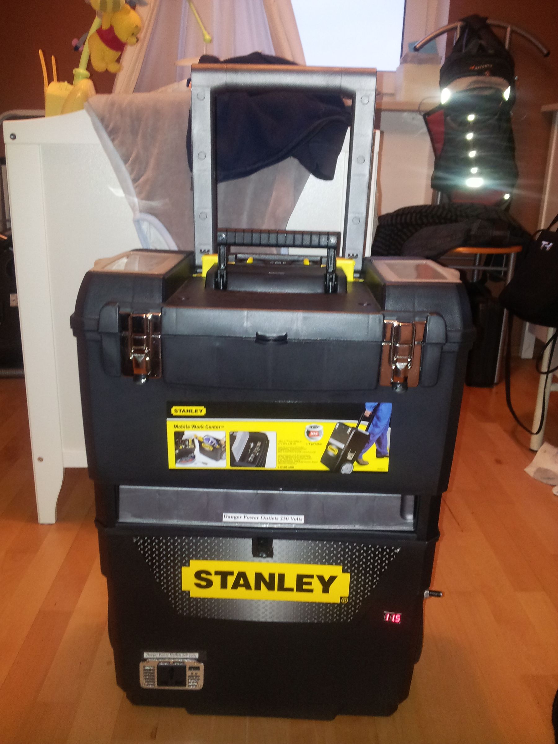

Step 22: More Charging Options.
Here I've added a couple more charging options from parts I already had lying around.. as usual.
1. 220-240V 500mAh European Charger.
2. 12V Cigarette Lighter Plug (for car charging)
*note: Both new charging options tested and working.

Step 28: Let There Be Light... Well Sunlight :D
Here is my mini solar generator WITH one of my solar panels. This one is a 45w solar panel. I also have an additional 45w and a 120w but I will only use them with my larger system... which I also have an Instructable and Youtube video for.
Note: I dragged this solar panel up fron the basement just so you can see it together. If you want to see it with the sun on the panels you'll have to use your imagination because I can do alot but I can't make the winter sun shine on a dark night. Therefore, this picture in my living room must suffice. It's not my only solar generator after all... just the smallest.
