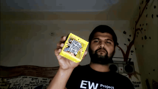

This is the Cube Light, a Small and compact cube-shaped emergency solar light that boasts a power output of 3 watts. The light is equipped with a high-efficiency 5V 80mA solar panel, intelligently positioned on the backside of the cube. To ensure convenience and versatility, I have ingeniously integrated four magnets, allowing for seamless attachment and detachment of the solar panel from the main body of the light.
This magnetic connection ensures a secure and reliable bond while still allowing for effortless repositioning and orientation adjustment to maximize solar exposure. Overall, my innovative solar light design not only presents a sleek and practical form factor but also prioritizes functionality and ease of use in emergency situations.

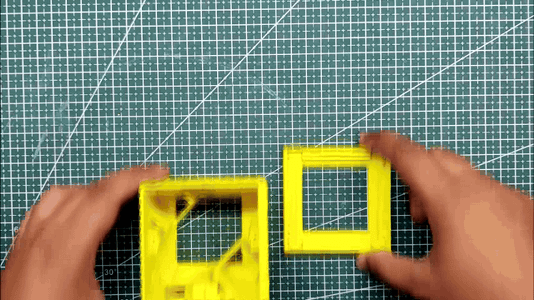

After attaching the parts, we create the mid-body, which will house the battery and another component—the LED Holder. The LED Holder, which will be housed inside the body and used to hold the LED PCB, will also serve as a closing cover to keep the lithium cell in position.
Next, we model a solar panel holder with four magnets located close to each edge. The magnets won't be held in place by anything other than a snug fit.
The solar panel will be held in place using double-sided tape.

Step 3: Adding Magnets to Hold Solar Panel Holder and Mid Body

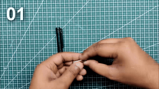

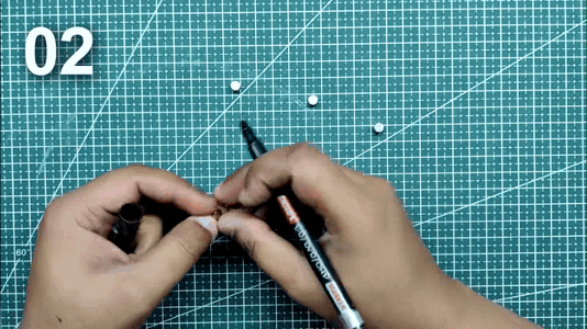

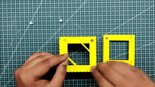

In this project, we are using Shiny round ferrite magnets, also known as ceramic magnets, which are a type of permanent magnet made from a composite of iron oxide and barium or strontium carbonate. They are known for their relatively low cost, high coercivity, and resistance to demagnetization.

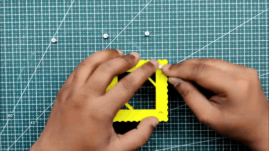

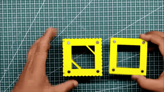

  • We first arrange them together to begin the magnet assembly; two pairs are needed for each edge.
  • In order to first attach four components to the midbody and then add the same pair to the solar holder, we mark each pair after that.

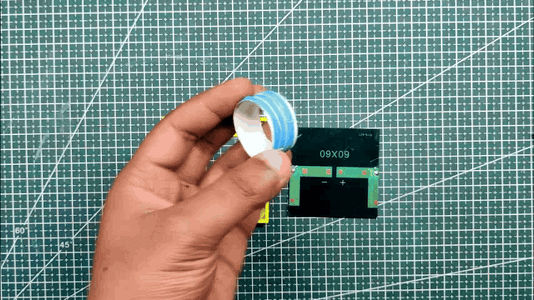

Step 4: Solar Panel Holder Assembly

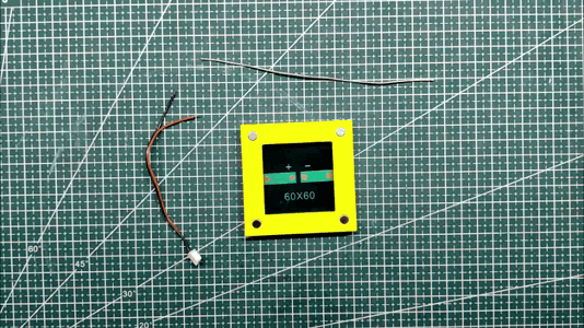

  • Placement of the panel in the 3D-printed holder with double-sided tape.
  • Next, we connect the wire harness's positive and negative terminals with the solar panel's PV+ and PV- using a regular soldering iron.
Step 5: Testing
After soldering the wires to the panel's PV terminals, we measure the voltage of the panel, which is 4.0V under light; when this panel is exposed to sunshine, we receive a maximum of 5.5V.

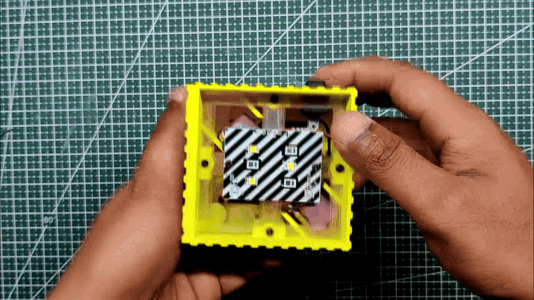

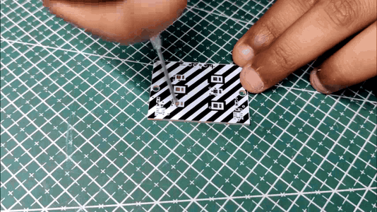

  • In the process of installing LEDs, we reuse an LED MCPCB from an older project, add solder paste to its component pads, and select and position the LEDs.
  • In this configuration, three Cree 3V/1W LEDs total are used, and they are wired in parallel.
  • The PCB is then placed on a miniature reflow hotplate, which heats it from below until the solder melts. As soon as the PCB reaches that temperature, the solder melts and all of the components are soldered to their pads.

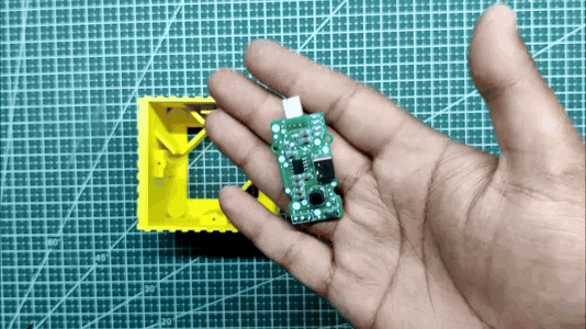

I use an IP5306-based charge module, which has a 5V output, an LED indication feature, and many other crucial features, to regulate the charge and discharge of Li-ion batteries.
The IP5306 is a power module IC that provides comprehensive power management capabilities for portable electronic devices. It is commonly used in applications such as smartphones, tablets, portable media players, and other battery-powered devices.
The IP5306 integrates multiple functions into a single chip, making it a compact and efficient solution for power management. Some of its key features include:
  • Battery Charging: The IP5306 supports various charging modes, including constant current and constant voltage charging, ensuring efficient and safe charging of the device's battery. It also includes features like overvoltage protection and overcurrent protection to safeguard the battery during charging.
  • Power Path Management: The power path management feature allows the device to operate even when the battery is low or absent. It can prioritize power delivery from the battery or external power source, ensuring uninterrupted operation and optimal battery usage.
  • Power Supply Regulation: The IP5306 regulates the voltage levels of various power supplies within the device, such as the main power source and auxiliary power sources. This helps maintain stable voltage levels for different components and prevents damage due to voltage fluctuations.
  • System Monitoring: The IC includes a monitoring circuit that continuously tracks parameters such as battery voltage, current, and temperature. This information can be used for battery capacity estimation, thermal management, and system performance optimization.
  • Efficiency Optimization: The IP5306 is designed to maximize power conversion efficiency, reducing energy wastage and extending battery life. It employs advanced techniques like pulse-width modulation (PWM) to control power delivery and minimize power dissipation.
Overall, the IP5306 power module IC offers a reliable and integrated solution for power management in portable electronic devices.
Step 9: Wiring
The wiring for this setup is extremely straightforward: the positive and negative terminals of the lithium battery go into the battery CON of the IP5306 Module, the JST connector added to the IP5306 Module connects to the solar module, and the LED load is connected directly to the battery with a resistance in series to control the current flowing through the LED load.

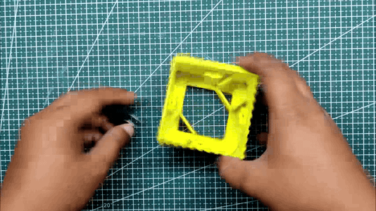

Step 10: LED Load Placement With Mid Body

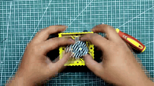

  • Following wiring, we attach an LED Holder there with four M2 screws.
  • Using the same M2 screws, we next attach the LED PCB to the LED Holder, link the positive from the switch to the positive of the LED load, and connect the resistor to the GND of the LED load. Here, a 1.5-ohm, 2-watt resistor is being used.

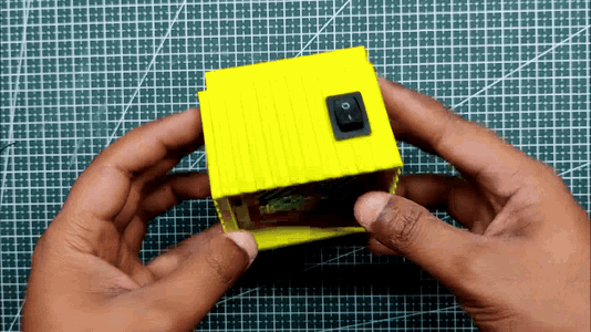

Step 11: RESULT
Here's the result of this small build: a small portable Solar Light that can be used during blackouts, camping, or just to illuminate anything anywhere, anytime.
The primary advantage of this system was the detachable panel setup. We could create a separate module to fit a different panel and attach it to the current system without altering the body structure. To replace the existing solar panel, we only need to create a new solar panel holder.
