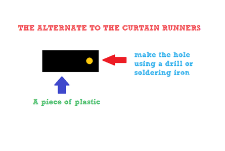

  • An alternate to the curtain runner can be a rectangular piece of plastic or wood with a hole at one end as shown in the given diagram.
  • You can glue this piece of plastic to the base using super glue or hot glue.
