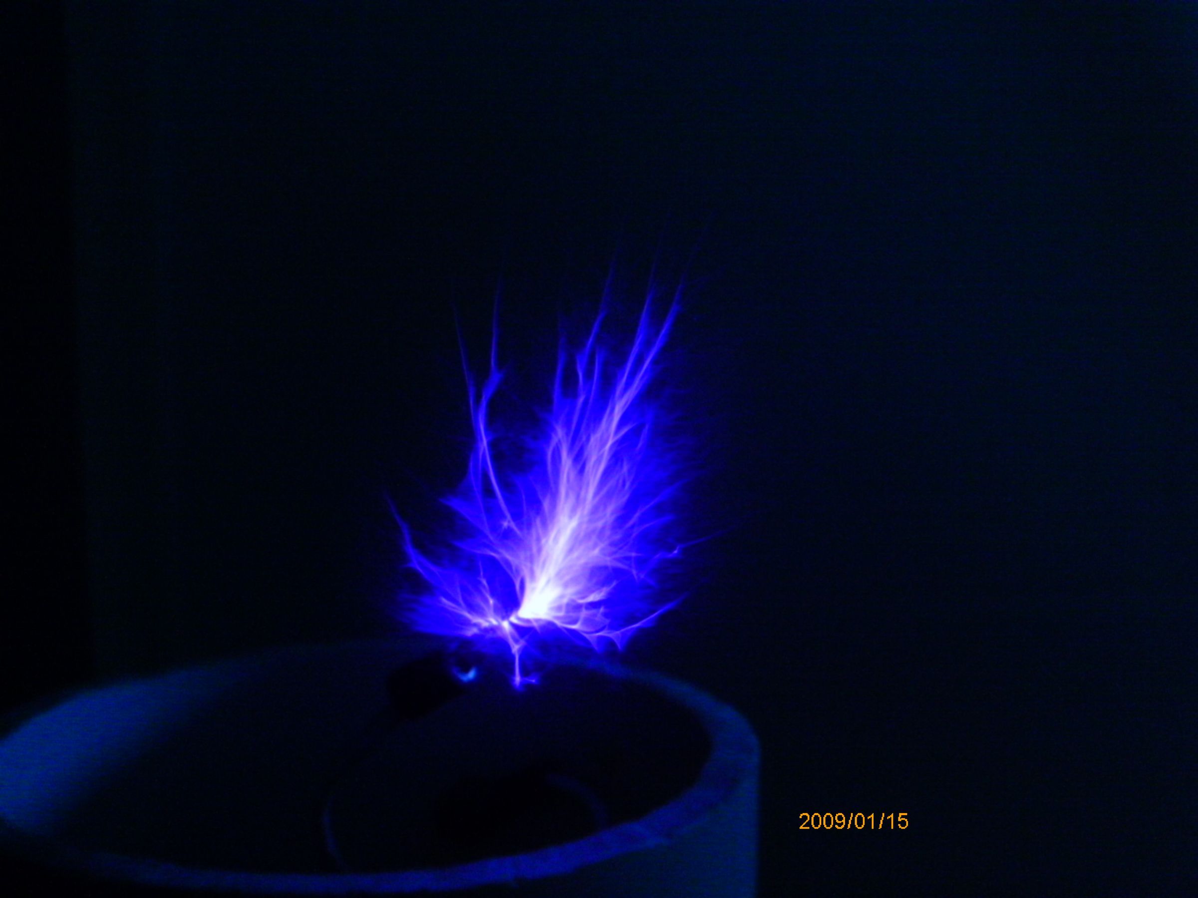

I made another coil out of the 30 awg wire. You will have to add more turns on the primary
Step 6: Toroid
I thought about buying a toroid to put on the top of it but im not going to pay 1 to 2 hundred dollars for one so I made my own! So your going to take the 1 Ft 2.5 inch drain pipe and curl it in on itself so it should be in a circle. Stretching it out a little bit will help it some. Measure the inside diameter of the circle and cut a piece of wood or cardboard and place it in the center of the tube. It will look like a space ship when your done! Take the Aluminum plated tape and start taping from the bottom of the cardboard, around the tube, to the top of the cardboard (it is extremely sticky!). Get the tape as smooth as possible! Its easier said than done but get is as best as you can! Once you got it covered with aluminum tape, Drill a hole in the center, put your nylon bolt threw the hole, place the washer and nut on the other side. Be sure to scrape the enamel off the wire to make a good connection with the toroid!
Step 7: Hook It Up and Make It Happen!
After that then your done! Hook it all up and play with it! You can see the arcs better in the dark than in the light I wish my cam could pick up the little arcs. Im sure if I had a better power supply to the flyback they will be more impressive! If theres any I left out or could make this better please give your input!
Sorry about the dark shot you cant see crap! my cam sucks!
