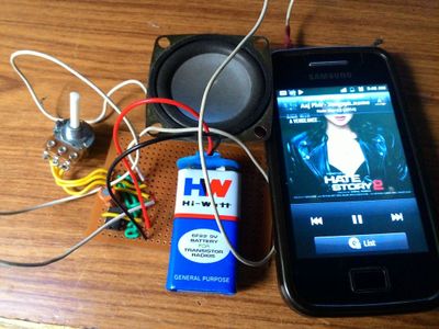

Today I'm going to make a mini speaker for Mobile or Laptop.... This project is for one of my friend on Instructables. Whose name is Verticees...

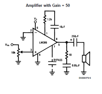

GAIN CONTROL
To make the LM386 a more versatile amplifier, two pins (1 and 8) are provided for gain control. With pins 1 and 8 open the 1.35 kΩ resistor sets the gain at 20 (26 dB). If a capacitor is put from pin 1 to 8, bypassing the 1.35 kΩ resistor, the gain will go up to 200 (46 dB). If a resistor is placed in series with the capacitor, the gain can be set to any value from 20 to 200. Gain control can also be done by capacitively coupling a resistor (or FET) from pin 1 to ground.

Step 4: Long Description Make It Short and Simple
If you don't want to go through the above steps then do one thing just follow this step..
place all components as like this picture then solder it on PCB Board. And now put all these in a box/ old mini speaker contaionr....

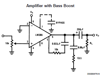

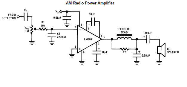

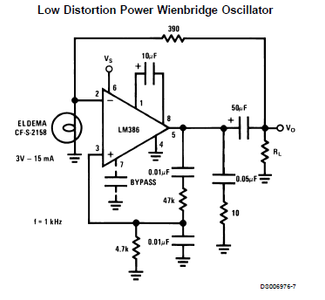

Step 5: Some More Effective Circuits
If you want to make your speaker more powerful then choose one of these circuits and if you can't understand any circuit then comment below and i will tell full description about that circuits
Step 6: Demo! Which I Made
Hope you Like It
If you have any problem related with it then comment below.
