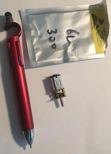

Clip on holder (came with the cans)
Toy Wheel
6-volt, 300 rpm motor with gears
USB C Battery connector
Shrink tubing

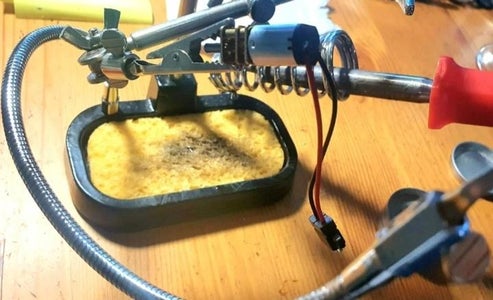

Step 3: Powering the Motor
To enable this, solider on a USB C leed to the motor.
Step 4: Heat Shrink
