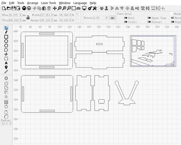

Step 1: Upload the File
Download this mini TV box file. Upload it into Lightburn, ensuring it fits within your machine working area.
