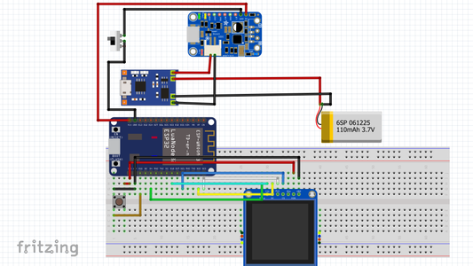

Step 1: Wire It Up!
You will need to solder this circuit because the ESP32 doesn't fit on a bread board, even if it did it probably wouldn't fit inside the case. Make sure you don't forget to set the output of the boost converter to 5v; to do this measure the output with a multimeter as you adjust the onboard potentiometer. If the voltage output is too high it could fry the ESP32[and possibly yourself], but if it's too low the ESP32 won't get enough power and the circuit won't work. Make sure all of your connections are secure and there is no opportunity for a short circuit. I use hot glue to solve both these problems as hot glue isn't conductive and holds solder to the board really well.
Connections:
Li-Po, TP4056 Charging Circuit
Vs-->B+
GND-->B-
TP4056, Boost Converter
OUT+-->VIN+
OUT(-)-->Slide Switch -->VIN(-)
Boost Converter, ESP32
VOUT+-->VIN
VOUT(-)-->GND
ESP32, 128x128OLED
3v3-->VCC
GND-->GND
18-->CLK
4-->MOSI(DIN)
22-->DC
21-->CS
RST-->23
ESP32, Push Button
3v3-->Left Pin
10k_resistor-->GND-->Right Pin
15-->Top Right Pin
(The circuit in the picture has been altered, please use connections above as a guide and NOT the image.)

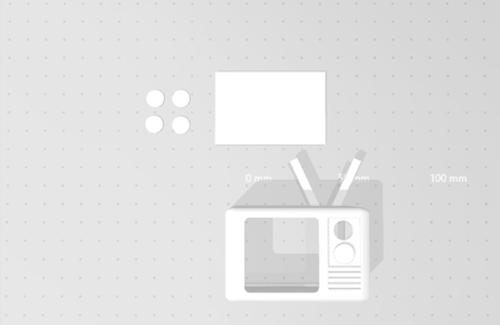

Step 2: Printing & Assembly!
Print time will take ~3.5hours, not too bad! After it's cooled down paint the whole thing poo brown[for some reason old TVs are poo brown] with a black border around the screen and control panel then throw some silver inside those black borders. As you can hopefully see the button goes through the front hole; hot glue works well for securing it in place[I love hot glue]. Then glue one of the circles onto the button from the outside. I have included 4 extra circles in the STL file, because 3D printers aren't the best at printing small circles such as these, or at least mine isn't. Make sure you put the screen and button in first, then ESP32, charging circuit, and finally boost converter with the Li-Po. Skadoosh, you just made an circuit board sandwhich.
.stl file:

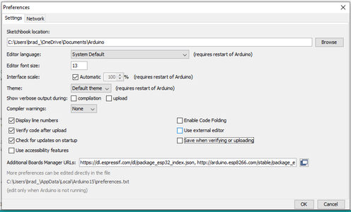

You will have to manually fill in your Wi-Fi credentials since I don't know them. Once you have done that go to Open Weather Map and sign-in if you have an account, or sign-up to get one. When you finish that you will be presented with an API key, copy and paste it onto line 17. [to turn on line numbers go to File>Preferences>Display Line Numbers] On lines 19 and 20 put your city name and country code in their respective places. Make sure you have all of these libraries installed:
WiFi.h, HTTPClient.h, Arduino_JSON.h, SPI.h, Adafruit_SSD1351.h, and Adafruit_GFX.h
[to install them go to Tools>Manage Libraries]
We are almost done with setup, all you have to do now is add the ESP32 to the boards manager. Go to File>Preferences>Additional Boards Manager URLs: and copy this URL into it: https://dl.espressif.com/dl/package_esp32_index.json. If you need to add additional boards later on for a different project just add a comma after this URL and add it.
