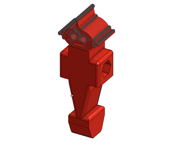

The next thing we did was create a CAD of our foosball table in Onshape. Our group created the CAD of the robot foosball players and handles. We then cadded the table’s walls and base and imported the hex bearings and shafts. Finally, we combined all of the parts together into an assembly. Note that a few elements of our fabricated foosball table ended up being different from the CAD(the goal size, part of the wall height, and the corner blocks).

Our group then gathered all of our printed materials. The prints were done in PLA filament. We printed 6 red and 6 blue foosball players, as well as 8 white handles. We also printed a 2” diameter ball and a 1.5” diameter ball. For the spacers, we just used a random collection of 3D printed spacers that were stored in our shop’s spacer drawer.

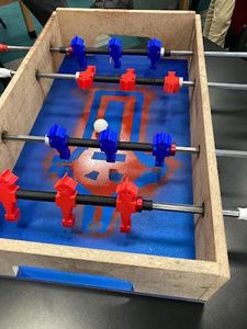

For some final touches, we super glued every single handle onto the ends of the shafts. We did spray paint two of the handles, but we decided that leaving the rest white was fine. To make the shafts that had a little resistance slide better, we constantly hammered and pushed them back and forth through the bearing(to try to wear down the resistance). We also added a bit more WD-40 on the shafts for good measure. And then we were finished with our foosball table!
Step 15: Design Reflections
Many of the challenges that we faced were ones we encountered during the actual construction of the table. We did accidentally cut two of the wall heights to the wrong length, so that is why they look not even(the wall height wasn’t too off, so we were still able to use it).
There is also quite a bit of dead space where the foosball players cannot kick the ball(especially in the middle of the field). We were able to address this a bit by making the ball bigger and letting the players move closer to the wall. However, if we had more time, we might have given the foosball players longer legs to kick farther. We could have also spaced the placing of the bearings to cover more space or even try to add 2 extra foosball shafts(we originally thought it wouldn’t have enough space).
The bearing holes were not cut completely accurately, which slightly slanted the shafts and likely made them harder to slide at first. This was very scary at first because we thought that we had to completely redo the long walls(which we didn’t have time for), but we were able to push the shafts through and make the sliding mechanism smooth with WD-40.
If you try to recreate our project, keeping these things in mind could save you some time! The sliding and kicking of our players work quite well with hex shafts, which we were surprised by. In general, we are very happy with our finished Metrobot-themed project and absolutely recommend using hex shafts and bearings for creating foosball tables!
