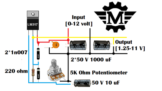

Step 3: Soldering Time...
Just solder everything with reference to the circuit diagram.
Additionally I also added an led and a switch. Solder the led as shown in the last image. The led will add a nice touch to our device. I have chosen red led as it gives the tornado a fiery appearance.
