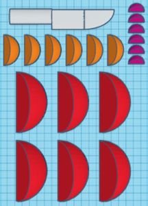

Step 3: Make an Orange
You're off to a great start! Now that you have your base shapes done, this will be easy. Hopefully.
Select all of the base shapes and duplicate them (I use the keyboard shortcut control+d or command+d to do this faster). Move them away from the first set so you can see what you're doing and resize them to make them a more reasonably-sized orange. I selected all of the pieces and resized them at once, making them 40 mm x 160 mm and 17.52 mm tall. I also made mine orange to help with color coding (coloring them on the software won't make a difference in the long-run unless you color code the 3D printer filament too, but it helps keep track of what's what). Here's what my build-plate looks like as of now!
Step 4: Make a Watermelon
Now, we're going to do the same thing we just did to make a watermelon! Take the orange slices & make a copy of them then duplicate each of the values. I also made mine red so they'd stand out and rearranged them so they'd fit on the build-plate.

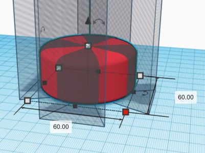

Step 5: Make the Cheese
This might sound cheesy, but you've got to brielieve in yourself! You're doing a really gouda job so far! Okay, I'll stop... but you have to admit that it doesn't get any cheddar than cheese puns.
Let's make some cheese!
  1. Import a "cylinder" shape
  2. Move all of the measurements in the top right menu to their maximum (64 sides, 2.5 bevel, 10 segments)
  3. Now, make it 60 mm x 60 mm and 28 mm tall
  4. Import a "roof" shape and make it a "hole"
  5. Make its width 38 mm and its length 41 mm. The shape's height does not matter, as long as it is taller than the cheese wheel we have created
  6. Duplicate it and rotate the new shape by 90 degrees, then move it so that the two triangle tips touch each other but do not overlap
  7. "Group" the two roofs
  8. Duplicate the group
  9. Rotate it by 45 degrees, so that they form a triangle-cross over the cheese wheel, as shown above
  10. "Group" the shapes, so that the triangles cut holes into the cheese wheel
  11. Add a "square" and make it a "hole"
  12. Size it so that it covers half of the remaining cheese wheel, as shown above -- the actual dimensions do not matter
  13. "Group" the objects
  14. Repeat steps 11 through 13 to cover one of the two remaining "slices"
  15. Just like with the fruit slices, rotate the cheese slice so that it sits flat on its long side
  16. Make 6 copies of the slice

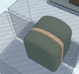

Step 6: Make the Bread
Now that we have tiny cheese, the only possible next step is to make tiny bread, of course, so let's get this bread!
  1. Drag a cube to the build-plate
  2. Using the menu at the top right, make its radius 2.23 and increase its "steps" to the maximum value
  3. Add a cylinder to the build-plate and increase its "sides," "bevel," and "segments" to their maximum value
  4. Rotate it by 90 degrees and make its height 11 mm
  5. Place it on top of the square (this was 11.5 mm up in my case)
  6. Group the two objects! I also made mine brown
  7. Duplicate the loaf and move one aside for later
  8. Import a "hole" cube and make it 1 mm thick and taller & wider than the loaf (actual dimensions don't matter)
  9. Duplicate the "hole" cube and move the duplicate 3 mm away from the original
  10. Select the two "holes" and duplicate then move them aside for later (it might help to group them)
  11. Now, on the original loaf, make the cubes wider than the bread (actual dimensions don't matter), as shown in the image above
  12. Group the three shapes. Ta da! You just made a slice!
  13. Duplicate this slice as many times as you'd like -- I did it three times to make a total of four slices (make sure to lay them flat on the build-plate)
  14. Now, take the two remaining hole-boxes and line them up with the edge of the other loaf to make an edge-slice, as shown above
  15. Ensure the hole-cubes cover the entire loaf except for that edge and group the shapes (if you grouped the holes earlier, you may have to ungroup them now
  16. Lay the end piece flat on the build-plate and duplicate it
  17. Size the bread as you like -- I suggest making it bigger than the cheese
