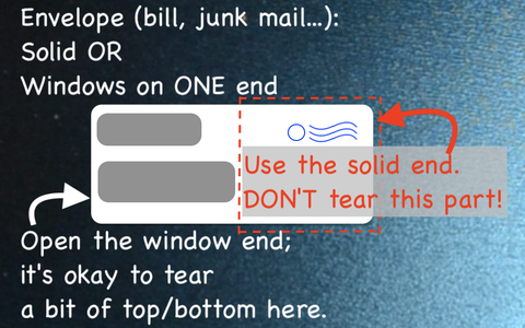

When opening bills or dealing with junk mail, choose a good envelope:
  • Reasonably sturdy (not especially flimsy)
  • Solid (no windows) OR with all of the windows at one end, such that half or more of the envelope is solid (see image)
To open the envelope, resist the urge to tear or slit the top. Instead, slit or tear one end (see 2nd image). It's okay if a bit of the top gets torn, just try to keep about half of the envelope intact.

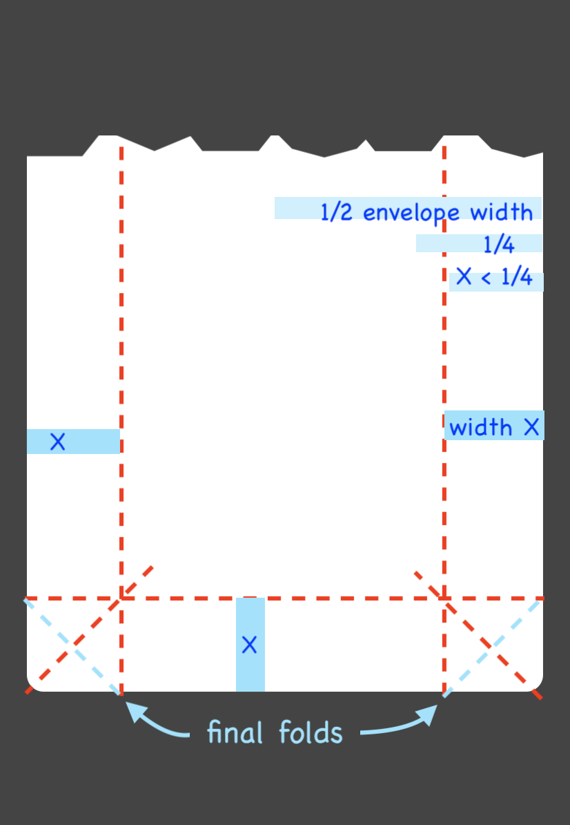

See the last image for a preview of how to fold the intact end. The center rectangle will be the front. The sides will be twice the width of the visible side rectangles (final width 2X), and the bottom will be twice the width of the visible bottom rectangle. (The widths all have to match at the bottom, or the bag won't work right.) The opened end of the envelope can be cut up and put inside as ballast.

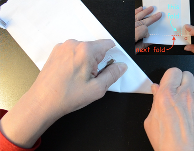

Look at the intact end of the envelope. Estimate about 1/4 of the way from one long edge (see photo). Make a fold, parallel to the edge, a little LESS than 1/4 of the way from the edge. Then open it back up.
If you make it exactly 1/4, you should get a square result, but the corners are a bit harder to fold neatly. (See the last photo in Step 6; indulge your preferences.)
If the fold is slanted, the bag might flare or slope. Don't do that the first time, but maybe have fun with the design later.
Step 3: Fold Bottom and Other Side to Match
Make a short, diagonal fold from the corner near where you just folded; open. This fold helps to mark the position of the next fold. This fold just needs to reach the first fold line; I don't fold it all the way across the envelope.
Fold the bottom up so that this new fold crosses at the same point the first two folds cross; open.  This fold defines the bottom of the bag and makes it match the width of the first side.
Make a short, diagonal fold from the other bottom corner; open. Again, it just needs to reach the previous fold.
Fold the second long edge inward so that this new fold crosses at the same point the previous two folds (bottom and second corner) cross; open. This fold makes the second side match the bottom and first side.
Refold each of the three long folds, backwards; open. When the trash can is open, one of the layers will fold one way, and the other layer will fold the other way. If your envelope feels crunchy (in danger of tearing), maybe do this refolding later, more carefully...or start over with a better envelope.
