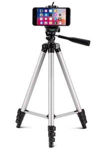

First let's look at how a tripod stand looks like: (refer to the first image)
So these are the main parts in a tripod:
  1. Legs
  2. Support beams
  3. Hinges for support beams
  4. Centre rod
  5. Sliding cylinder
All of them will be made using mounting board except the sliding cylinder and centre rod. The centre rod will be substituted with a used up pen, while the sliding cylinder will be the cap of the pen that is cut off.

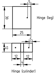

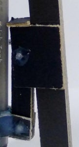

Step 5: Making the Support Beam Hinges
Sorry, no picture for this step, but I will explain with the 3D model.
Let's prepare the pieces first:
  1. On the legs - 25mm x 30mm - 2x3=6 pieces
  2. On the cylinder - 28mm x 12mm - 3 pieces
Drill holes and score at where needed (refer picture).
For the one on legs, glue the piece 55mm from the end with the side with hole facing inward with white glue. Repeat the same for the other side and other legs.
For the one on the cylinder, fold the pieces at the line scored. Then glue the pieces 120 degree from each other.
Now slide the sliding cylinder into the centre rod. Insert the support beams made in previous step into place and line up the hole. Then insert nail of appropriate size into the hole and glue it in place.
