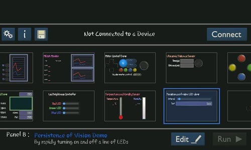

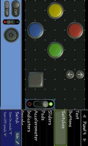

I used HC06 as controller.i used Bluetooth Electronic app for controll via bluetooth

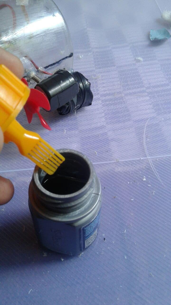

Step 5: Water Proof
