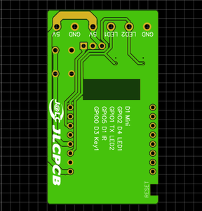

Step 2: Make a Custom PCB
For this WLED controller that I am making, I hope to make it as small as possible, so I am using SMD components as much as possible.
I use EasyEDA to design PCB and upload the design to JLCPCB.com to manufacture PCB.

You can use my gerber files to ordel your own PCBs, and build this DIY Project.
Just a quick example how to order PCB from JLCPCB.com:
1)press "QUOTE NOW"
2)press "Add your gerber files"
3)upload zip or rar
4)all properties could be left default
gerber files
https://github.com/James-workshop/mini-WLED-controller
