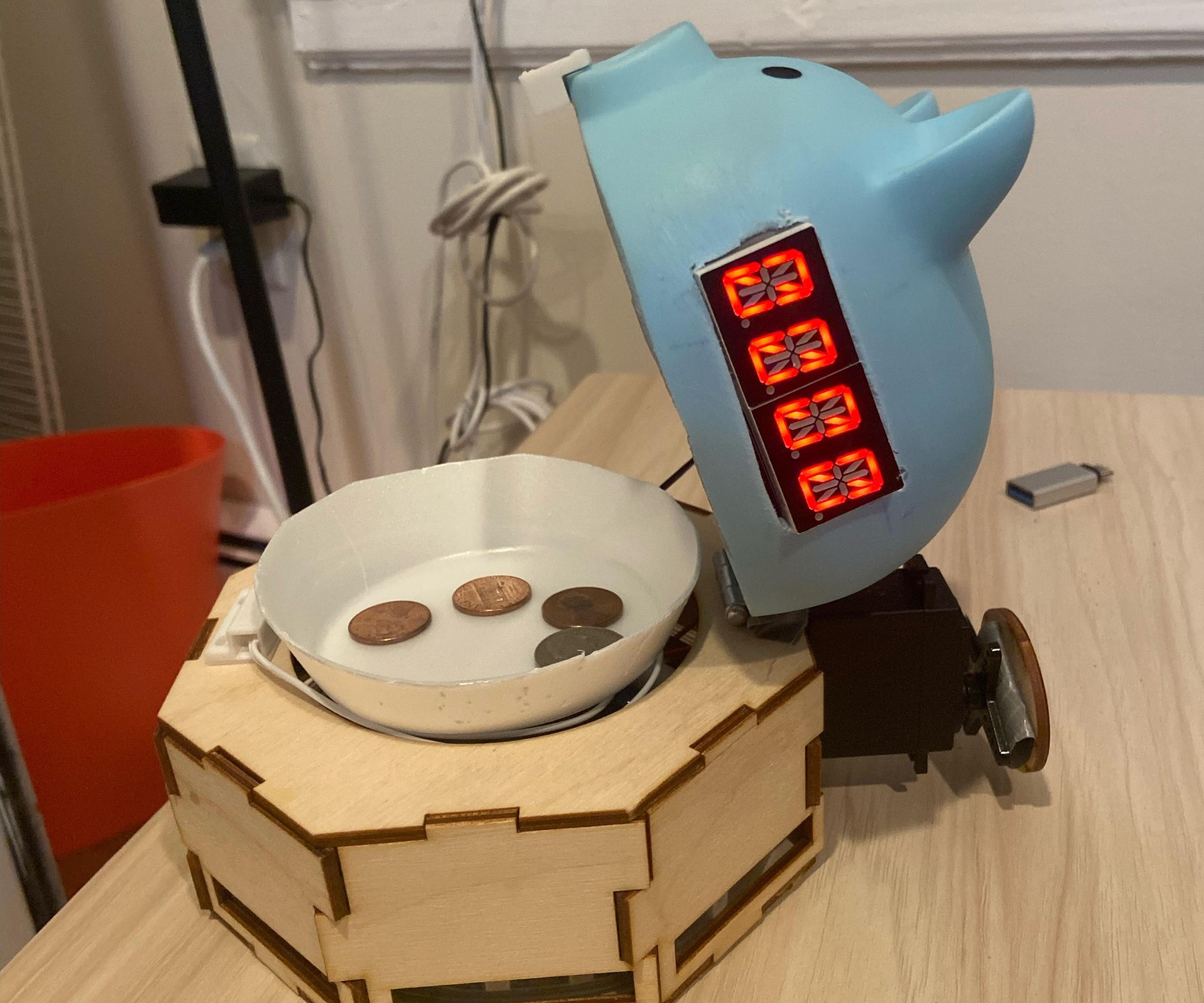

Step 1: Box Creation
- Make a Console2 box through boxes.py with front height set to 60 mm and angle set to 25 degrees.
- Laser cut rectangles and desired designs along the side of the box (so the lights can be seen from the inside).
- Laser cut 4 holes on each side of the top of the box for the mole buttons and one in the middle for the start button.
- Laser cut a rectangle above the start button for the time LED backpack.
- Laser cut a small hole in the back for the wiring.
- Put the box together using wood glue.
Step 2: Set Up the Box
- Line the inside of the box with the LED lights using duct tape.
- Place the buttons and LED backpack in their respective places.
- Super glue the buttons down and duct tape the backpack from the inside.
- Daisy chain the Botton board and the LED backpack together.
Step 3: Code
- Copy Code from above
- Download the corresponding libraries from Adafruit Bundles
- Use sd card with desired sound effects for the "play_sound", "play_sound_defeat", and "play_sound_high_score" functions
- Upload code into Mu and save as code.py.
Step 4: Put It All Together
- Attach the Pico W to the breakout board and connect the wires of the data cable, STEMMA QT, LED lights, speaker, and start button to their corresponding pin holes.
- Line the rectangular holes with parchment paper and tape with see through packing tape.
- Place all components inside the box and have fun!
