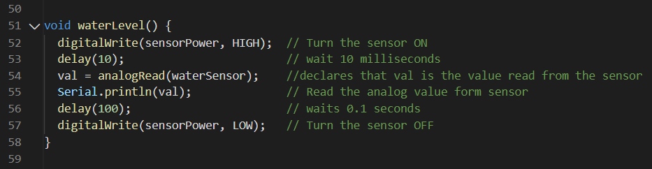

Step 6: Code (Part 3) - Measuring the Water Level
This part of the code measures the water level through the sensor and sets a variable as the value measured.
  • First we turn on the sensor and wait 10 milliseconds
  • Then we state that "val" will be equal to whatever value is read by the sensor, from 0 to 600
  • Next, we print the value on the Serial monitor. [HELPFUL IN EARLIER STAGES]
  • Last, we wait 0.1 seconds and turn off the sensor
The reason why we need to control the sensor by controlling the power is that prolonged contact with the water while the sensor is on can damage it and shorten its lifespan.
