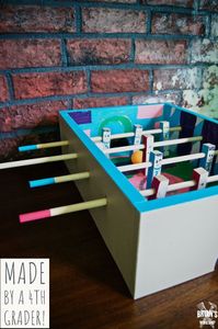

Step 6: Finished!
The finished foosball boxes!
