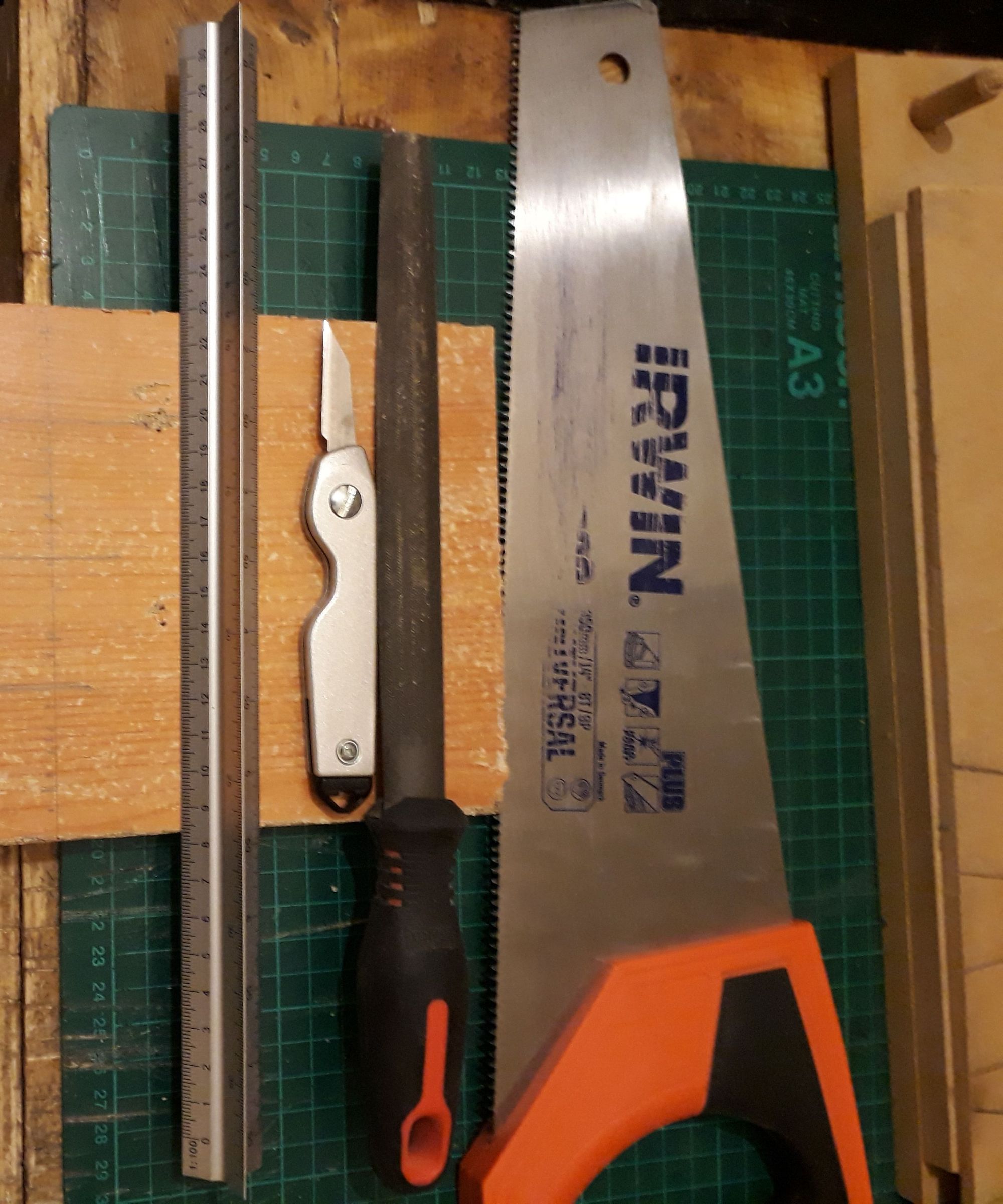

what you will need,
saw
ruler
pencil/marking knife.
2-3 inchs of hard wood,by-18 inch long-12 inch width .
drill,with no 6-8 spade drill bit
12 inch of wood dowel.
glue.
2 inch screws.
countersink.
router (optional)
2 bits of 12 inch by 2 inch wide, wooden battens.
plane,
chisel.
and same length as the hard wood & width, ply wood

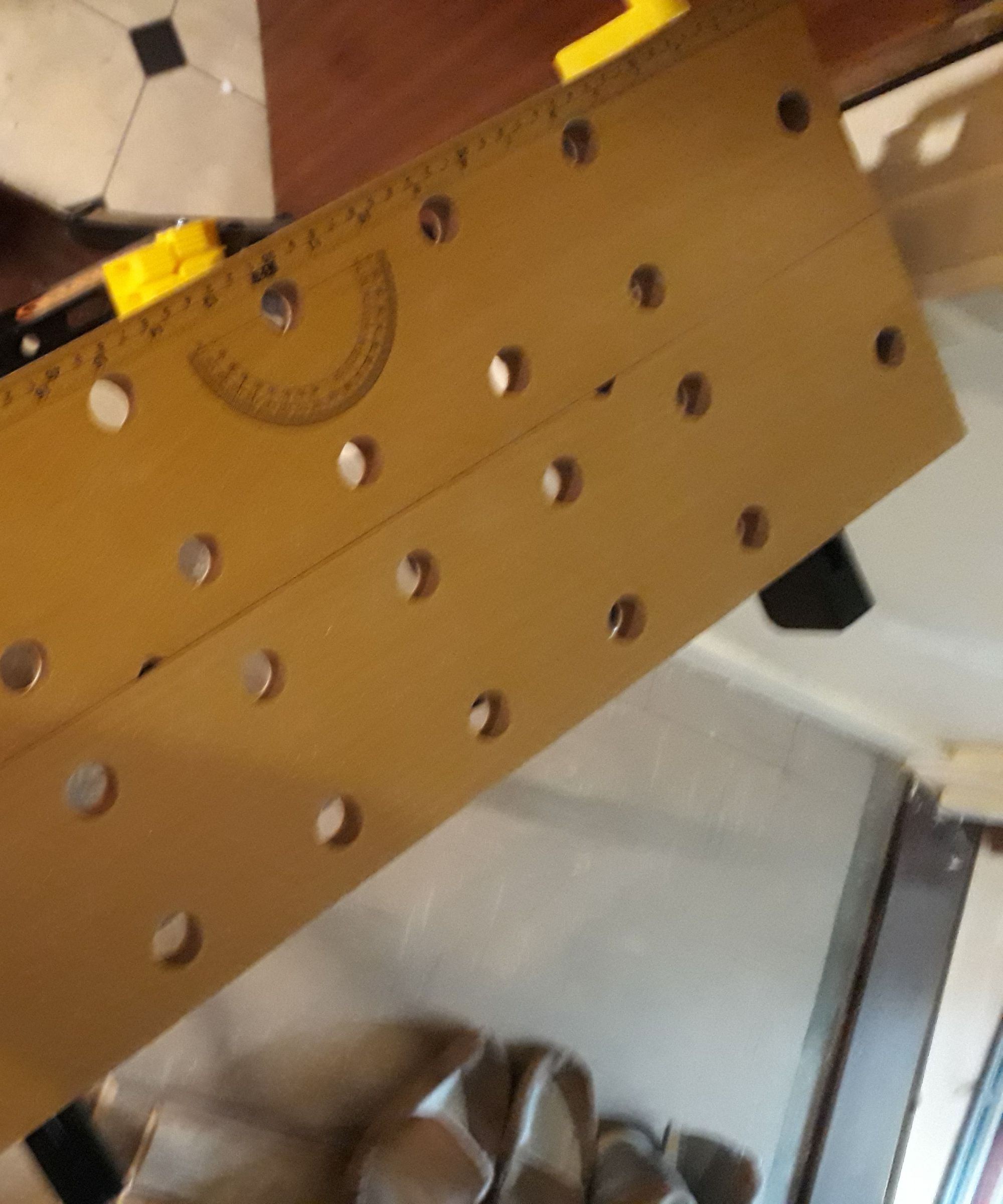

Step 5: Bench Plate ,as I Call It
now drill with your spade drill bit.
on the marks you made on the previous step.
go about 3/4 of the way into the wood.
Step 6: Drilling
bench plates
grab your 2 battens .
using the same drill bit .
mark the battens.
so the dowel can go through the batten and into the wood.
do this on both battens.
once finished as you can see in the pic.
the batten can move to any position i want .
and gives me a lot more room to play with.
also optional but its a great clamp.
with your 2 battens in place make the measurements , so that you have 2 bits of wood not to high that your bits of wood mountain over, about 1cm or so over is fine.
then saw from corner 2 corner (other corner opposite ).
then as shown in the pics put one on one side in the middle of the battens the other on the other side.
then what ever you want to clamp,place the work piece in the middle then push inwards until you get a solid hold,job done,
and believe me they work great,from a tiny bit of wood to large.
