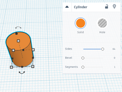

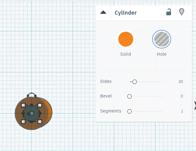

The first shape we add is a simple cylinder, which will be the middle of the mini-copter. The cylinder has to have a hole for the cocktail pick and has to be sturdy enough to hold all of the propeller blades
I use a cylinder with a radius of 4mm (diameter = 8), and a height for the two of 8 mm.
After The cylinder has been put in, you can select a hole in a cylindrical shape by selecting the grey cylinder. A hole Put it exactly in the middle, so there will be no imbalance. You can do this easily by switching to "bottom view" by clicking the cube in the top left of the screen. The hole has a radius of 2mm (diameter = 4), and also a height of 8 mm.
In this part you want to have as little mass as possible, the heavier the middle is the faster the mini-copter will drop to the ground. So I recommend only make the middle as small as you absolutely have to.

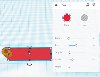

I start by adding a cube in tinkercad, by decreasing the height and increasing the length you get a nice flat rectangle that will be an ideal start for a blade.
Make sure the blade touches the middle by dragging the rectangle. Note that you don't have to worry the rectangle will cover up the hole you made for the cocktail pick, it will automatically make a hole in the rectangle aswell.

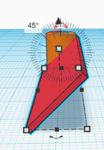

The next step is to determine a nice angle for the blade. The higher the angle, the better the blades push away the air. But if you lower the angle, the air resistance decreases and the minicopter can spin longer. I therefore choose an angle of 45 degrees.
You can easily apply the angle by clicking the cube in the top left, and view the blade from the side.

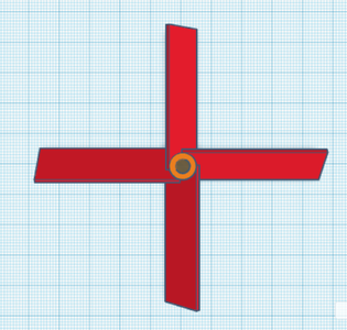

The next step is to duplicate the blade, so you can have as many blades as you want. I choose 4 blades, which I think is a nice balance between construction strength, having enough blades to fly, and being light enough.
You can copy and paste the first blade you made. By tilting the copied blade to the desired angle, and dragging it to the correct place.
Make sure to check if all blades are perfectly symmetrical by looking at your propeller from the bottom view. Otherwise the mini-copter will not fly stable.

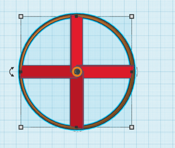

In order to make sure the propeller is less prone to breaking, and to make a sturdier connection, will add a tube around de blades.
Start by selecting a tube from the shape menu. Place it exactly in the middle. By altering the radius and wall thickness you can place the ring at the right position.
In addition to construction strength, the ring also adds inertia to the mini-copter. The larger the inertia, the more energy the mini-copter has, and the slower the propeller will stop spinning. Making the ring heavier therefore could result in a larger flight time.
In opposition to the middle, where extra weight results in very little extra inertia, the extra weight in the ring could improve the performance.

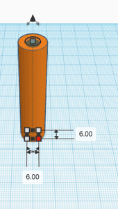

The handle makes sure you can hold the mini-copter while spinning the propeller up.
The design is quite simple. A cylinder with a radius of 5mm, and a hole with a radius of 3mm (slightly bigger than the middle of the propeller, to ensure there is little friction) the height is 55mm which fits nicely in your hand.
