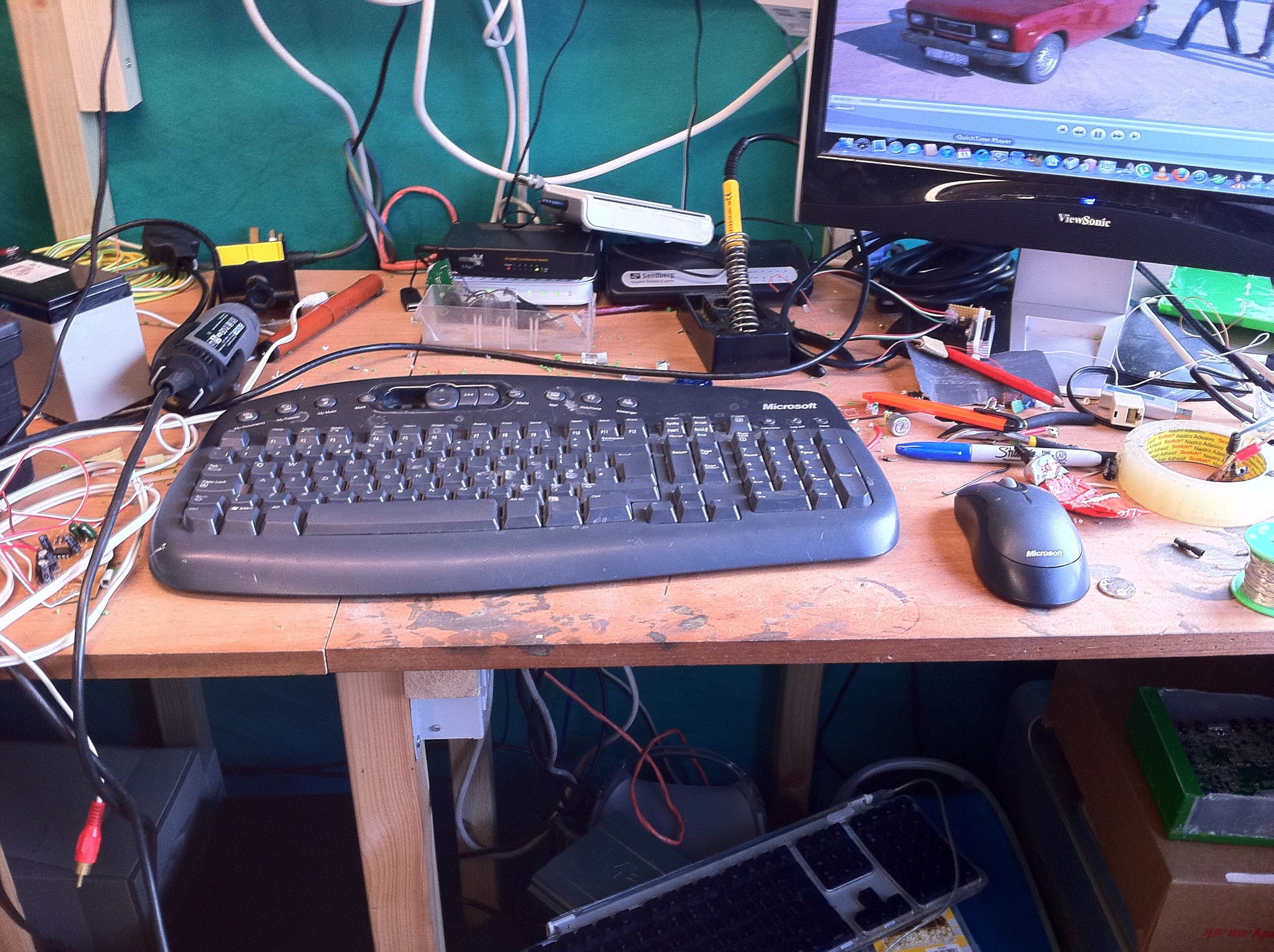

Step 1: Tools
tools:
small flat head screwdriver (to take 9v battery apart)
soldering iron
hot glue gun
wire strippers
stuff:
5v regulator (can be found in Meany eletronics, i got mine from a ps1)
usb socket
wire
solder
hot glue
electrical tape
cardboard
soldering iron
hot glue gun
wire strippers
stuff:
usb socket
wire
solder
hot glue
electrical tape
cardboard
