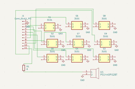

(sorry if the schematic and board is a little messy and wonky its my first PCB that i have made:)
here is the schematic files:
for the Gerber files please click on this link to go to a google drive page to download:
MiniBeeps Gerbers

Step 4: Soldering PCB Pins to the XIAO ESP32-c3
time to solder the PCB pins to the XIAO! grab 11 wires here are the connections:
Wires to XIAO:
PCB B1 - XIAO D0
PCB B2 - XIAO D1
PCB B3 - XIAO D2
PCB B4 - XIAO D3
PCB B5 - XIAO D4
PCB B6 - XIAO D5
PCB B7 - XIAO D6
PCB B8 - XIAO D7
PCB B9 - XIAO D8
PCB BUZZER INPUT - XIAO D9
PCB GND - XIAO GND
make sure to solder all pins to the top of the XIAO and bend them down so it fits in the case
