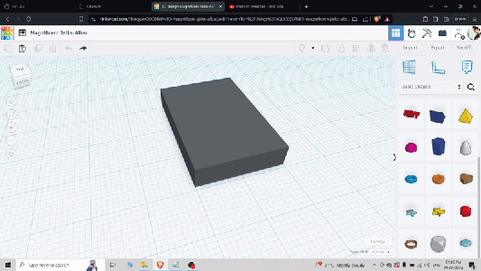

  • Launch Tinkercad and start a new project.
  • Begin by placing a box shape onto the workplane, which will serve as the base of your keychain.
  • Adjust the dimensions of the box to 20x30 mm to comfortably accommodate a 5x7 grid of round holes.

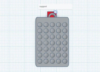

  • From the shapes panel, select a ball shape and resize it to create a round hole. Duplicate this cylinder to create multiple holes arranged in a 5x7 grid pattern on the top surface of the box.
  • Use Tinkercad’s alignment tools to evenly space and align the holes in the desired formation.
  • Add a hole at the top center of the box for attaching the keychain ring. Ensure this hole is large enough to accommodate your keychain ring.
