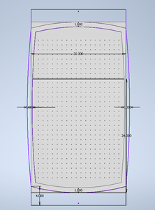

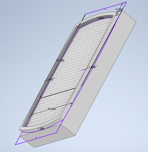

Step 2: 3D Modeling
The plan from the very start of the whole process was to design the walls and floors of the table in AutoCad, and then laser cut them out and assemble, sort of like a big puzzle. That is ultimately the route we took yes, but before ever opening AutoCad we first modeled what we wanted the whole table to look like in Inventor. The reason for this is that before actually going through with printing everything, we wanted to sort of visualize how all the pieces would fit in with one another. In the attached photos of the final air hockey model, you will be able to see the following:
  • The dimensions of the horizontal walls
  • The dimensions of the vertical walls
  • Distance between both parallel planes (Which makes the air chamber)
  • An overall look of the desired finished product
The process of making this model was rather simple, just simple sketching and extruding. Being as the table is such a boxy surface with literally no curves other than the deposit, to 3D model your own would just require that you type your dimensions to your wants and needs. For us, as we are working in a 20x12 limit that is 5 inches tall, we made sure all sketches fit within this size. From there, you just need to make all the walls and floors to your needed thickness (Which in our case is 1/8" as that's the thickness of the wood) and you're golden. Now we can begin designing the cuts.

Something crucial here are the holes and little teeth you see on the boards themselves. The purpose of these 2 creations are to provide the mechanism that will be used to connect the boards together. Both the height of the teeth and size of the holes will be 1/8", meaning that it will be a seamless fit as that's the thickness of the wood as well. To make these teeth, we first had to settle on how many we wanted. We felt that 4 on the long side and 2 on the short side was appropriate. Next we sectioned off both sides into 4 equal quadrants and 2 equal halves respectively, to make sure each tooth was spaced apart exactly the same. Lastly in those sections, we went up 1/8 and moved 1.5 units to both the left and right, to make sure that the tooth was 3 inches long. We did this in every section in both the long-side and short-side and finally mirrored over both to create the final piece. (A little extra thing we had to do was scale down this plank and every other one as well by a factor of 0.953, so that it was a little smaller than the actual wood we were cutting. This is done to make sure the board is only cut within its boundaries, and not outside.
To then make the holes, we took the same 3 inch by 1/8 inch sizing that we used for the teeth but moved it over to the side walls, which are noticeably smaller than the platforms. We went down 1.5 inches and over 1.4082 before placing to make sure the tabletop wouldn't rest completely at the top and would have small walls for the puck to bounce around in, and so that the pegs/teeth fit perfectly together.
Next up was making the big goal hole for the puck to go through when someone scores. This was easy enough as all we had to do was place a large rectangle above the peg holes, which would then be sanded down from said hole to make sure that there was no barrier stopping the puck from going through.
The last little step we had to accomplish was making a large circular hole in the bottom of the chamber to allow a fan to blow through it. This again was easy enough as we just needed to find the diameter of the fan we intended to attach and place a hole the same size. To know which fan this would be, we went back to the physics forum and looked at the classifications of fan needed, and went on amazon and found one. We used this fan for the process, while still being ready to pivot and find another

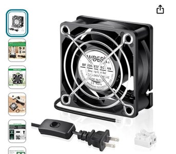

Step 6: The Hunt for the Fan
While we already knew the dimensions of the fan we were going to use for this project, we didn't know exactly how strong this fan needed to be. It is because of this that the "Hunt For The Fan" starts. This quest involved a lot of talking to teachers and people asking around for spare parts and any advice. Our original thought was to take apart a spare PC from a computer science class and use an old PC fan, by soldering the wires and attached to a volt battery. However we are no electricians so this wasn't going to be any old easy task. Nevertheless, we did exactly that, and began dismantling 2 PC's and extracted two different fans:
  • A Pano-Mounts Black High Performance Cooling Fan
  • An LED Antec 3 PC Fan
Both fans were roughly the same size but had varying levels of strength, and to be fair we didn't know what those strengths were being as they were old and in a PC, meaning they had been worn down and not at top efficiency and quality. This is where the idea to solder comes into play, as if we can power these fans with a volt battery we can then test and see their power.
When it came to soldering however, we couldn't find an available 12 Volt battery (Which is what would've powered the fans) anywhere in the building, meaning we had to find something else out. We went onto Amazon and bought a few different computer fans that were of the same size, but settled on an easy to use, an WDERAIR EC Axial 3 Inch Muffin Cooling Fan. Once the fan came in, we brought it over to the workspace and was ready to give it a shot.
Step 7: Attaching a Fan
Using the large hole and 4 smaller holes in the corner, we were able to attach the fan onto the bottom plank that will be used to create an air chamber. Because we had all the dimensions of the fan, its outer casing and positioning of the nuts and bolts, everything was an easy fit (Except for us putting the mini holes 45 degrees rotated wrongly the first time, which it an easy thing to avoid). We lined up the fan with all the holes in the correct spots, slipped the bolts through and on the other side twisted the nuts all the way up until the fan was secure. Just like that the fan was attached and all wood components were accounted for

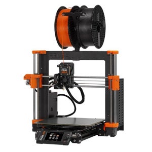

Step 8: Printing Pucks, Paddles & Goals
Moving on from laser cutting to 3D Printing, we have 3 things that we need make that will not be out of wood:
  • The Puck
  • 2 Paddles
  • 2 Goal Deposits
To model these we went back into Inventor, as Inventor is compatible with a 3D Printer. To start we made 2 different sizes of pucks, one rather thick and one quite thin. Making the puck was another easy process. We first made a circle 2.5 inches in diameter, and in 2 separate files extruded up by .5 an inch and .2 and inch respectively. After that we simply filleted the puck on the top and bottom edge by a factor of .5, meaning that it had a nice roundness after all is said and done.
The paddles were next up and it was another rather easy process. We first created a circle that was 3 inches in diameter and extruded up by very little, 0.25 inches. We now had another puck looking thing but on the top surface of that, sketched and extruded another cylinder up. Then on this handle, we started a sketch from a vertical midplane of the up-most cylinder, and drew a quarter circle that was half the diameter of the cylinder, and revolved it around the side l-ine of the quarter to create a full semi circle. This was the handle done. The last little step of the paddle involves making the upwards lip thing. To create this, we started another sketch on the outermost ring of the paddle and extruded up a tiny square. On this square, we re-sketched on its outside surface the same shape and revolved it around the central axis of the paddle, making a nice extruded ring on the outside of the paddle. We filleted the edge of this ring again to make it smoother and the paddle was done.
The last thing we made was the goal deposits for the puck to go into. To make these, we measured out the length of the goal itself and made a rectangle that had the exact same dimensions, extruded out 4 inches to give a big enough frame to house the puck when scored. From this rectangle, we filleted the butt-end to make it rounded. Lastly, we created a shell to actually have a space for the puck to go. Once this was done, we printed them out.
I printed all these models using PLA Plastic off of an Original Prusa MK4 3D Printer kit. The resulting pucks and paddles were very nice and similar to the 3D models we made of them in Inventor, and will act really well with the rest of the table. These are the last physical aspects that are needed to be printed.
