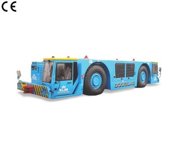

I based the design mainly on the TUG Alpha 5 in the first picture. I also added an oversized hitch on the back to make it easier to attach model aircraft to it.
Print the main body and the wheels. In the second picture the wheels are a bit different. Those were my first attempt, but I wasn't happy with how they looked, so I designed and printed the set in the last picture. The files are for the main body and the improved version of the wheels.
