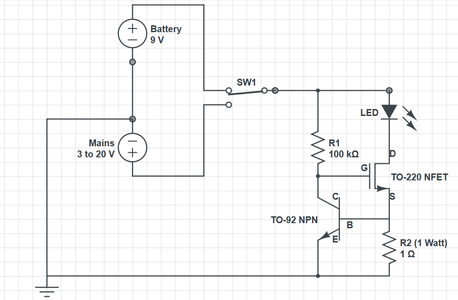

Step 3: Build the Circuit
The circuit I used is a basic constant current driver. I learned it from dan's great LED driver instructable, you can read all the details there as well as find a few other circuits that may suit your needs better if you're going off book.
In the context of this project there are a couple of steps we have to take while building the circuit to make everything go together.
I would recommend building a test version of the circuit on a breadboard just to make sure you have the right set of components. Once you understand the construction of the circuit you can start to build it onto the PCB.
At this point you can attach everything but the LED. In this version I did not add a plug for a transformer but because of the switch used it is as simple as drilling a hole in the base and soldering the plug to the switch and V+ node in the circuit.
With the rest of the circuit ready, place the LED into the barrel and feed it's wires through a couple of holes, giving them a twist on the backside to keep everything in place. Feed small gauge extension wires through the cover, small axle, and side of the barrel. Solder the extension wires into the proper places in the circuit. I used some splice clips I got a while back to make the final connection between the LED and extensions but any form of inline splice will work.
Test, test, test. If everything is working properly it's time to button it all up.
