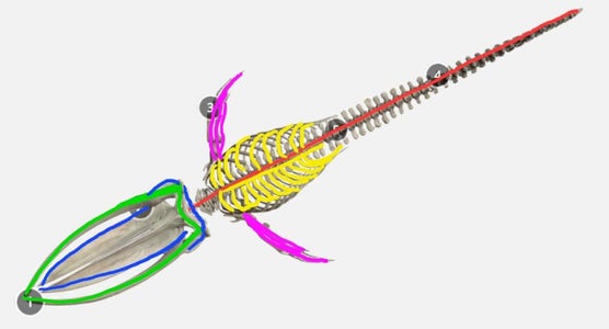

Step 2: Blue Whale Skeleton Design
Creating a miniature whale skeleton of a blue whale with a 3D pen might feel like an impossible task. But do not worry, if you create it piece by piece it's easier to do, though it will take some patience and trial and error, especially if you're new to drawing with a 3D pen.
Also, luckily for us, the Natural History Museum made a 3D scan of the whale skeleton that you can find online:
https://www.nhm.ac.uk/discover/blue-whale-skeleton-3d.htm
To design my whale I took screenshots of a top-down, bottom up, and a sideways view of the skeleton and scaled them down to my preferred size. Since my skeleton is very small, and the nozzle of my 3D pen is relatively thick, I had no option but to simplify the design. If your model is bigger, you can use the scan of the whale as a reference to make it as detailed as you like.
Print or trace your design on paper so you can use it in the next step.
Step 3: 3D Pen Skeleton
Tracing the prints, I started by 3D drawing each part separately. I used wood-filament for a more 'rugged' texture:
  1. The spine (red lines in the sketch): directly traced from the print, including the spikes. 'Overshoot' the spines, drawing them a bit longer than they need to be. This way you can cut them to size while they are still on your paper.
  2. The head (blue): start with an outline from the top down view, then fill up to the thickness of the side view. Look at the 3d model for reference.
  3. The beak (green): first drawing the outline, based on the shape visible in the bottom up view. Then curving it by carefully using some heat from a lighter (be very careful, don't melt your filament completely, just heat it for about half a second). I used a roll of painters tape to get the right curve, just push the warmed up shape on top of the curve and wait for a few seconds until the filament cools down.
  4. The fins (purple): 2 shapes traced from the print, look at the 3d model for reference. To curve them I used the heat from the head of the 3d pen.
  5. The ribs (yellow): these might be the most difficult, since they have a curve. To create this I used a thick round promarker pen wrapped in painters tape as a placeholder. It takes some patience to carefully peel the drawn ribs of the painters tape, just loosen each part by lifting it up slightly with your fingernails, without breaking it. I cut the ribs to size afterwards.
After creating all the separate elements I 'welded' them together using my 3d pen and filament as if it were a hot glue gun.
