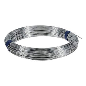

Dig the site to the required depth to remove loose soil and reach a stable base for dam construction. Cut 2mm steel bars to required lengths as per the structural design drawings using cutters. Place steel bars (rebar) in the excavated base to strengthen the concrete foundation and resist structural loads.
Step 2: Foundation : Reinforcement for Base Structure
Bend the bars into rectangle using bending tool according to bending size. Follow the grid pattern and spacing requirements ( 2 cm ) from structural drawings.
Then run each of the 40 stirrups through horizontal bars. There is a 2 centimeter space between each stirrup. Next, secure each strip with a wire and tweezer. The process takes a long time.

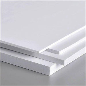

I use sunboard (3–5 mm thick) sheet to make shuttering.
Sunboard (also called foam board or PVC foam sheet) is a lightweight, rigid material often used in modeling and architectural prototypes. It's easy to cut and shape, making it ideal for miniature construction projects.
Cut Sunboard sheet in size and place both side of reinforcement. Glue sunboard pieces together to form a dam mold. Use clear tape or silicone to seal inner seams if pouring liquid. This prevents leaks and keeps edges clean.

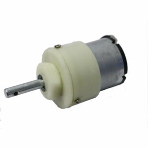

Step 14: : Gate Lifting Mechanism : Install Gate Lifting Motor
Mount the electric motor that will lift and lower the sluice gates to control water flow.
Step 15: Gate Lifting Mechanism : Install Sliding Door
Fit the sliding door into the guide rails to regulate water discharge. Connect this door to shaft of electric motor. Ensure all mechanical and electrical systems are correctly aligned and operational.
