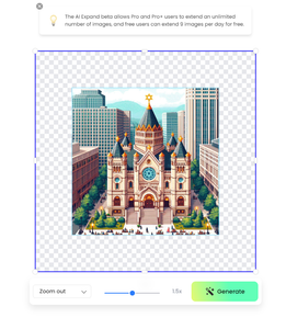

Step 4: Extend the Images
It's all great except for one issue: the generated images have a 1:1 aspect ratio, while the 2.4-inch TFT LCD with ILI9341 has an aspect ratio of 16:12. To avoid cutting off important parts of the picture or stretching it, you can use another AI to extend the image.

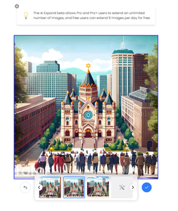

To extend the image using Fotor AI Image Extender, follow these steps:
  1. Go to fotor.com/features/ai-image-extender/ and click the "Extend Image with AI" button;
  2. On the new page, click the "Open Image" button and navigate to the downloaded image;
  3. The generation process will start after you click the "Generate" button. If you haven't logged into your Fotor account, it will prompt you to do so. If you don't have a Fotor account, don't worry, you can create one for free;
  4. Fotor will generate three versions of an extended image. Choose the one you like, hover a cursor over its thumbnail, and click on the download icon to download it.

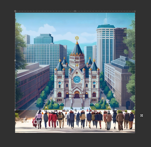

Step 5: Crop and Resize Images

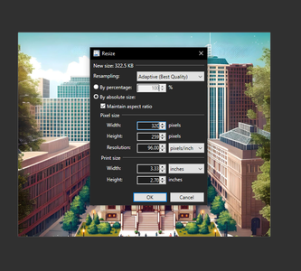

In order to display images on the LCD with ILI9341, it is necessary to resize and crop them. You can use any software to perform the resizing and cropping tasks. However, the following instructions are specifically for the Paint.net graphic editor:
  1. Open the image that you wish to resize and crop;
  2. Select the "Rectangle Select" tool from the toolbar on the left-hand side of the screen;
  3. Use the tool to draw a rectangle around the portion of the image that you want to keep;
  4. Once you have the rectangle in place, press "Ctrl+Shift+X" to crop the image;
  5. After cropping the image, it needs to be resized. Click on the "Image" tab in the top menu and select "Resize" from the drop-down menu;
  6. In the "Resize Image" window, set the width to 320 pixels. Ensure that the height of the image is at least 240 pixels. If the height is less than 240 pixels, set it to 240;
  7. Once you have set the new size, click the "OK" button to apply the changes;
  8. Crop the resized image again to make its size 320x240 pixels.

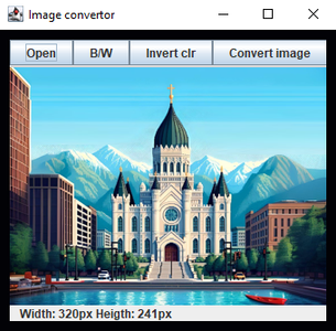

Step 9: Convert Images to the 16-bit Color Array
To convert an image to a 16-bit color array, follow these steps:
  1. Right-click on the "Image Converter" project;
  2. From the pop-up menu, select "Run As" and then choose "Java Application;"
  3. When the program opens, click on the "Open" button;
  4. Navigate to the 320x241 image that you want to convert;
  5. Click on the "Convert Image" button.

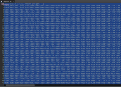

Step 10: Copy Converted Images to the Sketch for Raspberry Pi Pico
After you have finished converting an image using the Image Converter program, close the application and open the "565_color.txt" file. Next, rename the array to "picture_N," where N corresponds to the image number, and copy the array to the Raspberry Pi Pico firmware. Once you've done that, return to step 9 and repeat the process for the remaining images.
