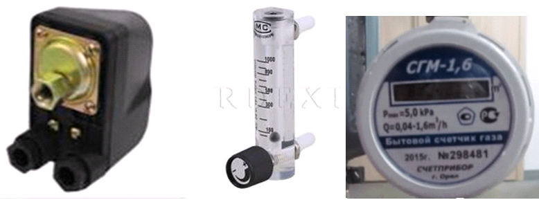

Another feature would be to add electromechanical pressure relay like used in air compressors to cut the current. For example from Ebay ”AC 250V 1/4" Port Air Compressor Automatic Pressure Switch 1-5 Bar”. A gas flow meter can be installed electronic or floating ball type.
