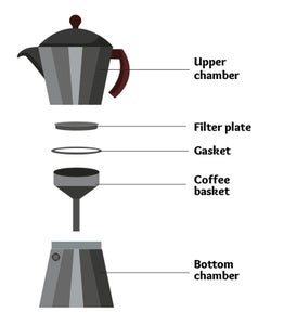

Step 1: The Parts of the Pot
Before we head to the worktable, let us take a moment to understand all the parts of the moka pot that we will be making. I will be using these terms to refer to the parts while explaining, so you can refer back in any case.
  1. The Upper Chamber: Folded from the metal sheet with some polymer clay details
  2. The Lower Chamber: Folded from the metal sheet with some polymer clay details
  3. The Lid: Folded from the metal sheet with some polymer clay details
  4. The Handle: Mainly sculpted with polymer clay except from the hinge
  5. The Filter basket: Sculpted with clay
I decided to not include the filter plate and the gasket at all, as it did not add a whole lot to the piece in a miniature. And in case you want to make just the whole pot instead of making it openable or in parts, then you can skip a few steps for each of the parts and not make the filter basket at all.

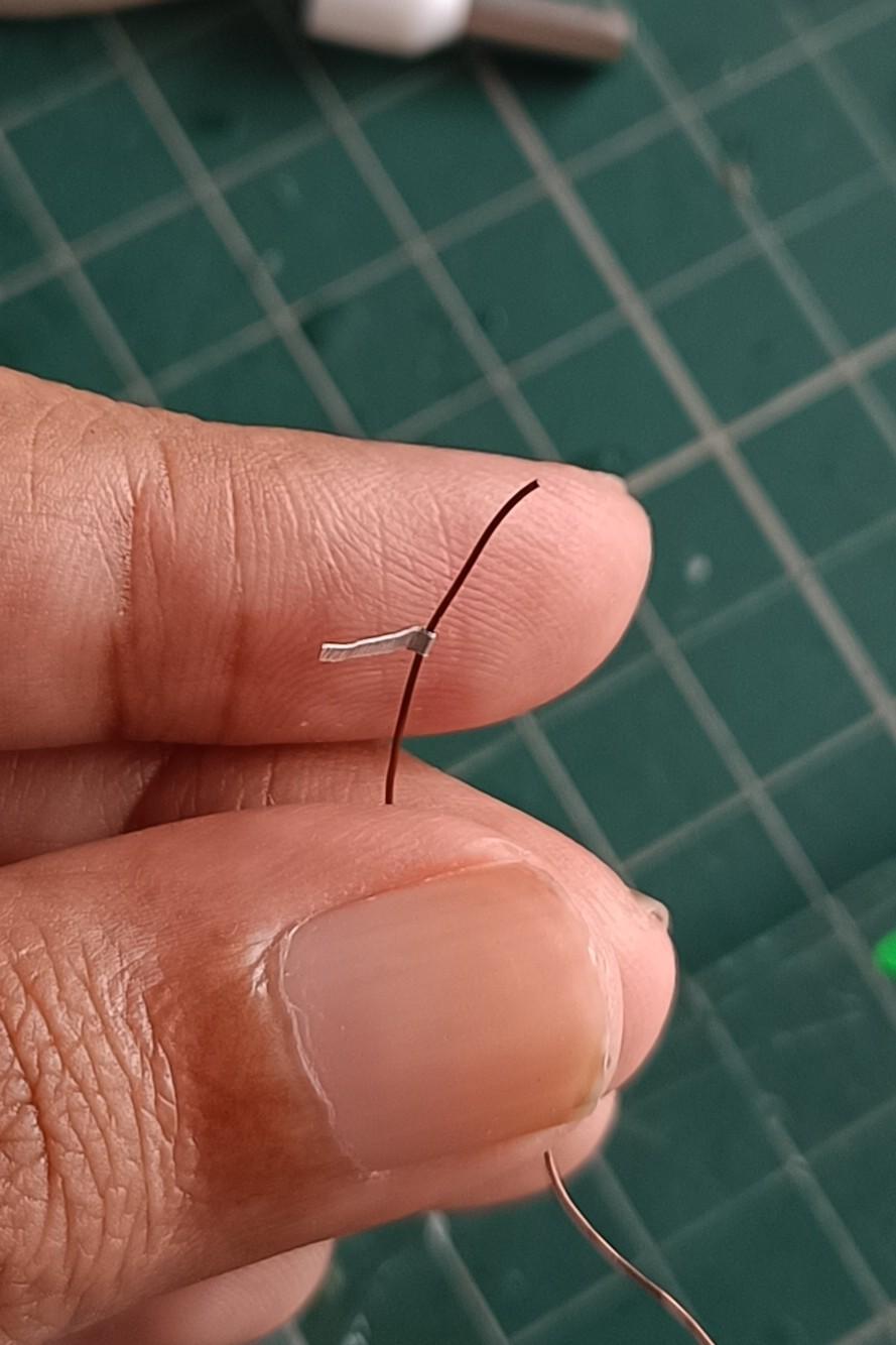

  3. We will need another strip of the metal now. Make sure the combined thickness of the two clay triangles and the width of the strip are as close to the thickness of the handle as possible.

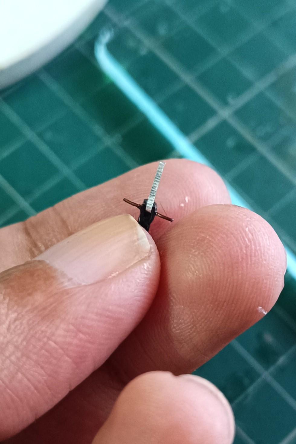

  4. Wrap the strip around the piece of wire to form a simple hinge. You don't have to glue this down; instead, just overlap the wrapping to hold it in place. As it is a very small piece, the glue can spill over and block the movement completely.
  5. Once the handle and triangles are baked, we can put the hinge together. Pass the wire through the hole of the triangle attached to the handle and secure the wire with a tiny drop of glue from the outer side of the triangle (not the one with the metal loop).
  6. And once that has dried, pass the other triangle through the piece of wire so as to sandwich the metal loop with the two pieces of clay. Just like before, secure the wire sticking out with a drop of glue.
  7. Snip the extra metal from both sides after it has dried completely.
  8. With the super glue, attach the handle base to the side of the upper chamber diametrically opposite to the mouth or spout. Ensure the metal loop is still moving freely.
  9. Glue the metal loop to the folded lid. Move the loop outwards so it's more accessible and cut it to size in case it is longer than necessary. Then put a drop of glue on the tip and place the lid on it. I used a tweezer to hold it together as it bonded.

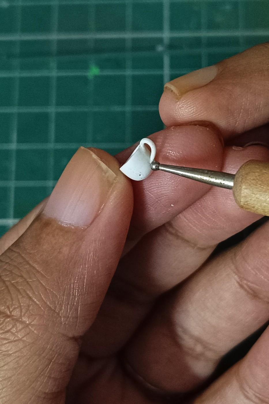

  4. For the cup:
  5. An espresso cup is smaller than a cappuccino cup or a regular coffee mug. And that is what I wanted to make. I found the end of my number 10 round brush to be the perfect size and close enough in shape. Just raid through your brushes or pens to find the one you like!
  6. Gently drape the second circle we cut out from the clay on the edge. Slowly press and pull down to evenly cover the tip without tearing it and while avoiding folds.
  7. Once it the shape is there, go around with a blade to cut off the excess and get the neat and even edge. Pre-bake once.
  8. Once cooled, attach a little rolled-out snake of the white clay as the handle to the side. Put a drop of liquid clay on the tip and place the strip going upwards and blend it into the cup's body with a ball tool.
  9. Once it is smooth, gently curve the handle downwards and attach the other end as well. Bake once more, and it's ready!
