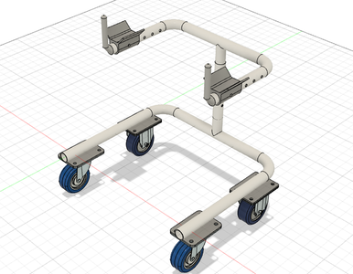

Step 2: Designing the Mini Walker
The design is relatively simple with inspiration drawn from existing walkers - an aluminum frame that accommodates switchable caster wheels while having armrests and handles on the top.
Fusion360 was used to create the necessary CAD models. Dimensions and requirements given by the physical therapist were taken into consideration when designing the walker.

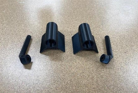

Step 3: 3D Printing Grips and Arm Rests
Hand grips, armrests, and caps to cover tube ends were 3D printed.
MakerBot 3D printers were used to produce the parts. Parts were printed at 100% scale with a higher than default Infill density, and an increase in shell count to increase their strength.
Foam padding would later be added to the arm rest to ensure a more comfortable experience.
