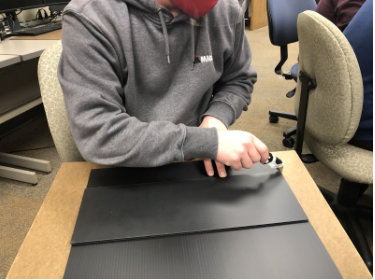

To begin the construction of the box, the plastic card board must first be cut down to size.
  • Take 5 plastic cardboard sheets and cut them down to 1.5ft by 1.5ft squares.

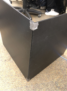

  • Take 2 1.5ft x 1.5ft squares and tape the corners of both squares together making a hinge.
  • Repeat the last step using another sheet to form a "C" shape on the ground.
  • Now using the tape, tape along the seems where each sheet meets one another.
  • Taking another sheet, place it on top of the "C" and tape along the seems to create the floor.

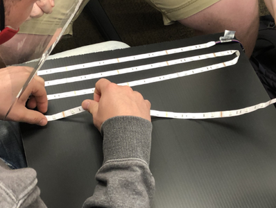

  • With the last sheet, the LED light strip will be placed on one side.

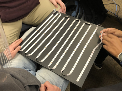

  • Starting in a corner, peel back the adhesive and stick the light strip about 3 inches down from the edge.
  • While slowly pulling back the adhesive, begin sticking the light strip to the sheet making an "S" pattern until the entire strip is attached.

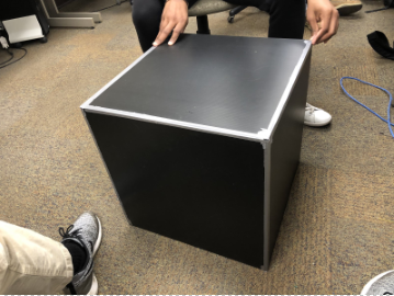

  • Flip the box upside down so the floor of the box is on the floor of the ground.

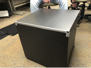

  • Place the sheet with the lights attached to it with the lights facing towards the ground on top of the box.
  • Now tape the last sheet to the rest of the box.
