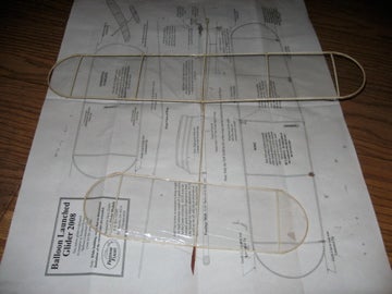

Test you receiver and see if it will work with the one cell lipo or phone battery. If so great you can make an Indoor plane. If not you can try to make one, no guarantees. If yours works with the 3.6 or 3.7 volt battery then you can replace all of the wires with a really thin wire to further lighten it up. Make a battery plug out of the computer connectors with the female side on the battery. You can take the cover off of a phone battery to make it even more light. Here is a link to a really good place to get more info on indoor planes if you want to do that. http://www.rcgroups.com/indoor-and-micro-models-85/ The transmitter will still work with the original aircraft if you don't want to make your own. Pictured is a model I built for the Science Olympiad which could be converted over to RC
