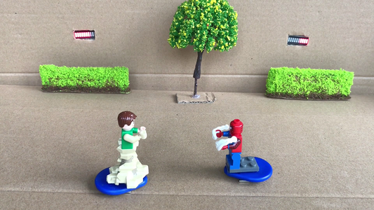

In this game, players use minifigures mounted on tag and push the minifigure towards the opponent's minifigure using stick so opponent’s led bar will drop by one. the winner is the final player who has not let their led bar drop to zero.

The first step to gather all material including cardboards, a ruler, a pencil, scissor/cutter, and a hot glue gun. Once you have all the materials, next step is to measure and cut cardboard pieces according to the provided dimensions. You can use ruler and pencil to mark the cardboard before cutting it with the scissor/cutter. After cutting the cardboard pieces, you can start assembling by gluing the pieces together using hot glue gun.
Attach 2x6 plate lego and the tag using double sided tape. Attach magnets on the left and right sides of the back of the cardboard, and also attach magnets on the left and right sides of the top of the cardboard to prevent the top from being lifted upwards.
Step 5: Play the Game
Bring the tags that have been attached with magnets close to the RFID reader, which is also attached with magnets on the top of the cardboard, so that the two magnets attract each other. The RFID reader will read the unique ID from the tag. And if the UID matches the UID in the code, Arduino will change the state to true, and the LED Bar will have a scrolling effect. Push the minifigure towards the opponent's minifigure using stick so that their RFID reader doesn't detect their tag, causing the LED bar module to decrease by one.
